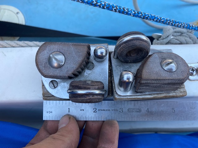

Postby Newbflat » Thu Sep 01, 2022 12:44 pm
I’m replacing the old cleats on our early 70’s DSII. They are just too hard to cleat in a breeze, especially with my growingly arthritic hands. I’m curious on how they are held on to the centerboard trunk? Are they just screwed into the fiberglass? Is there any wood backing? Going to go with some harken cam cleats with fair leads unless anyone has a better idea.

Postby GreenLake » Fri Sep 02, 2022 5:13 am
1034
Now, I'm sure something like that would fit on a DSII, but let's see whether anyone knows the details. As far as I know, the DSII has the CB trunk and cockpit molding nested like russian dolls, instead of the bare CB trunk as on a DS1.

Postby Newbflat » Mon Sep 05, 2022 12:33 am
Lol… that is on my DSII. I want to replace it.
