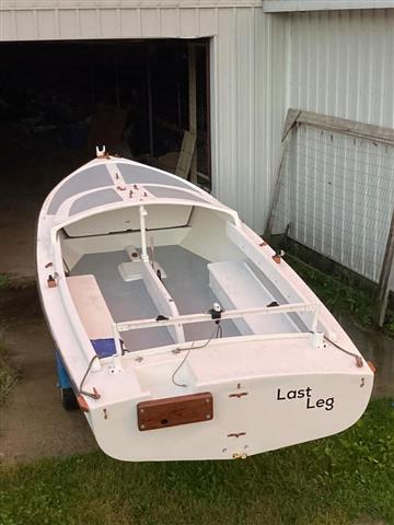

I want to either buy or make a few sets of hiking straps for my 17' Daysailer clone. My setup is a little different than the usual daysailer, so, while I can obviously through-mount hardware for the hiking straps on the transom, since I have no cuddy lip on my model (it might look like a lip on the picture but it's actually a ledge to an elevated cuddy shelf, with no access from behind) -- I'm guessing I need to epoxy/glass hardware somewhere forward for mounting the straps. And, since transom to cuddy is a long span, having some middle mount to split the strap in two, or at least loop it through, maybe on the centerboard trunk? In general, I'm also just unsure of how tight/how close to centerline hiking straps should be. Here's my boat for reference.

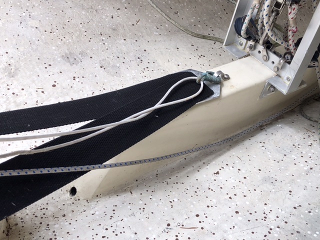

Postby Chetcosailing » Wed Mar 29, 2023 5:30 pm
My Daysailer’s hiking straps are attached at an eye pad inside transom, and another on the keel between the centerboard trunk and the mast step, one continuous seat belt web strap for both sides. To keep the span of the strap where you can hook your feet, it’s suspended by features under the thwart boards, and a small loop of line under the lazarette. In my picture the loop has dropped from its anchor point under the lazarette.
