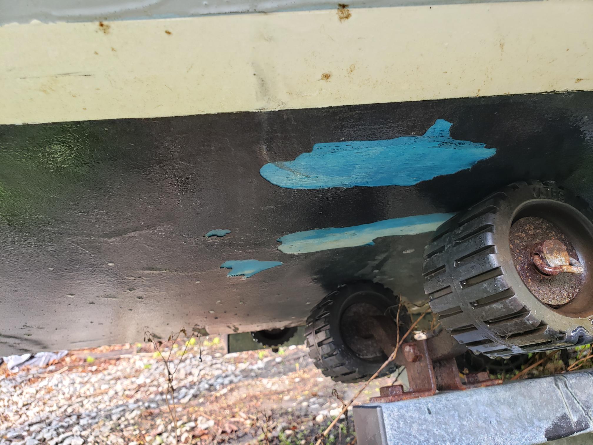

I uncovered and was going about washing the daysailer II with plans to get it in the water this week.
I noticed the underside has paint coming off..
I honestly don't know what the normal technique of painting the bottom is so can't really diagnose best action.
I am assuming and hoping, its an additional layer and not something more disturbing.
The hull flexes slightly where it sits on the wheels on the trailer.
Again, an assumption and hope that this is fine..I have been sailing it all last summer with no issues and it performs great.
Obviously I am not going to get my best speed like this. But can I get away with it and repair the patches, with advice on best technique appreciated, or am I looking at having to do the entire bottom ??

First. Do you keep your DS on a mooring or in a slip? Then you want some antifouling paint and that does look like it might be something like that.
Second, if you like to sail your DS, you won't be happy with a paint job that is that rough and / or flakes off.
AF paint is intended to be reapplied periodically, the interval depends on the type. This one looks like it's failing and should be scraped off. Whether you put new AF paint on your boat depends on how you use it. If it lives "on top" of a dock, instead of "next to one" or if it lives on a trailer, then the boat is being "dry sailed" and you can use a variety of paints that don't normally like being submerged. Those tend to have a 24h, 48h or 72h window, which is generous for the typical daysail and might work for a short overnight cruise. (If you pull your boat fully on the beach overnight while cruising, you should be able to push that window a bit longer).
If you do apply AF paint, try to find one that goes on smooth, or, if you can, talk to sailors in the same waters for recommendations, because different brands/types work differently depending on local marine growth (and some waters may have their own regulations).

From the images it looks like bothe the black and the gray paint have failed. Normally that means full removal. The DS isn't that large so the total bottom surface isn't much more than a few dozen square feet.
But you could leave the gray painted area for the fall.
I don't have direct experience with anti fouling paint (if that's what's currently on your boat). So I can't advise you on what you need for your lake. From reading online, if you keep your boaton the trailer in the winter, you would be looking at ablative AF paint.
You may want to do an Internet search for recommendations for freshwater use. Make sure whatever info you get is recent as AF paints tend to get reformulated to reduce environmental impacts.
Whatever your choice, it should be smooth after application or you'll be sailing with the parking brake on.
The kind of rollers you have on your trailer are a poor choice for the DS as the wheels create point loads that flex the hull.

Postby stillwaterfield » Fri May 16, 2025 10:48 pm
Quiggers73 wrote:Could you point me to the best way to remove the old paint, or a good guide to the hull painting process..
Working on my hull last week and this week. I tried hand sanding with a block to get the crud of years off. Finally I bought an orbital sander. I got the crud off and a bit into the gelcoat. I found a few blisters and opened them up. I found a few scrapes and faired them out. I found some crazing and opened those up and faired those too. Lots of sanding. I then applied an epoxy coat, sanded it, and am applying the finish topcoat layers now with light sanding in between. And then wax and buffing it out. My boat is trailered now and doesn't sit in the water. So I don't need an anti-fouling paint.
I guess while I'm at it, I may see if there's a way to switch those rollers for a more even load bearing on the trailer.
I hated how my trailer left black marks on the hull. So I made bunks for the back two thirds of the boat and changed out the other rubber rollers for the plastic non-marring ones. If you make bunks make them long and wide and angled to make the best contact. Keep rollers for the front.
Oh, and flipping the boat. I did it in my garage. First I put up some vertical support beams so as not to mess with my modest garage roof trusses. Then I put some straps under the boat and lifted it up off the trailer. Flipping the boat involved a pully system that allowed me to flip it my myself. It's on blocks now so I can get at the bottom easily to patch and fair.
