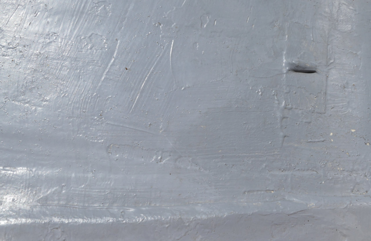

The first photo shows how I deliberately left brush marks when applying the gelcoat. My main reason was that I didn't want to sand and fair the bilge to perfection, so this helps blend with existing imperfections. I also had not given up on the idea of perhaps restoring the floor boards, in which case the part I did in the first two batches of the repair would have been hidden again. In the end, I liked it enough to also do the CB trunk and left everything exposed.
Aft third of cockpit with gray gelcoat

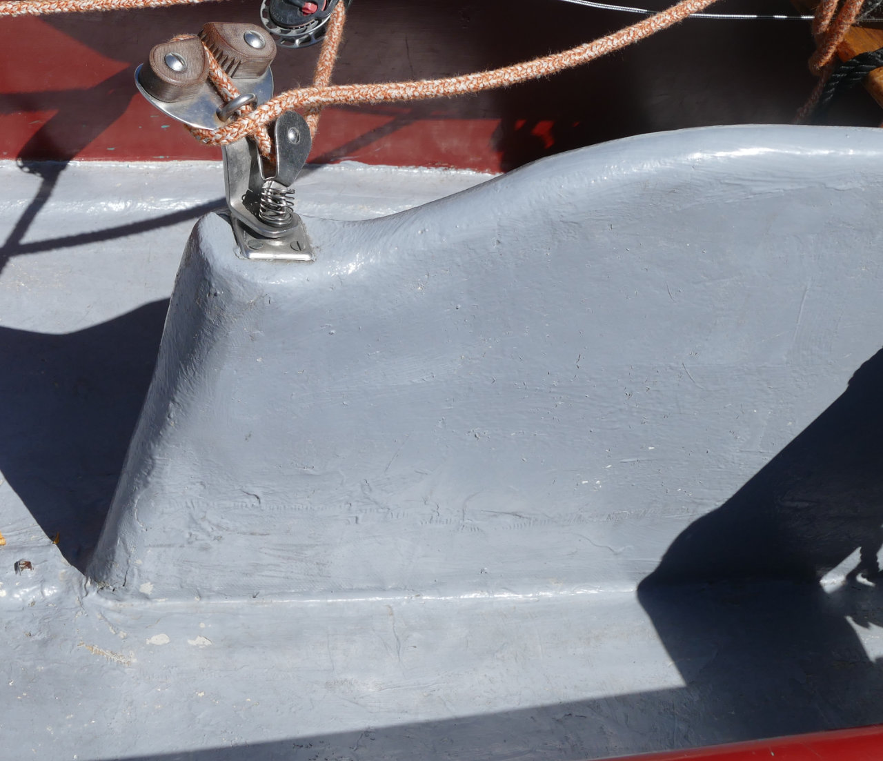

The second photo shows the CB trunk, with a visible repair from the PO at the bottom edge. Probably a bit of laminate to hide a crack where it meets the hull. It's still visible, but much less than before. I should have probably sanded off and redone the repair, but impatient. In front of the repair are a few spots where the gelcoat failed in small patches. That was one the areas I worked on first, and likely made the mistake of spreading the gelcoat too thin (and not spraying it with PVA). Small areas seem to not have cured, but merely "dried", and subsequently scuffed off. The damage is largely on one side only.
To fix it would require color matching a batch, grinding off the affected area, and then re-gelcoating it. It still looks so much better than the "raw" bilge did before that I'm not super motivated to do anything about it.
Middle section of bilge and CB trunk
Overall, this looks better, especially the parts I stand and walk on when raising the mast, than I would expect from any of the paints I've used. I was definitely a bit too cavalier on the prep and should have practiced my technique in a hidden spot first. The gray color worked as intended, nothing shows on it. If you look very closely at the first picture, you'll see that the bilge hasn't been cleaned for a while, but whatever smudges there are are not "in your face".
