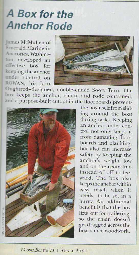

WOODENBOAT Magazine had a great anchor stowage idea in their "Small Boats" special edition a few years ago. The person built a more or less triangle-shaped box, about 3-6" deep, sized to hold the anchor and line. On the boat they showed (an open, double-ended design ,about 18' long) the owner had cut out a part of the floorboard forward to allow the anchor box to fit into the floorboard, but you could install a few wood cleats to hold it in place. On the DSI this could easily be placed forward of the mast inside the cuddy. I've attached a scan of that idea from WOODENBOAT.
I keep my anchor, a 4S Danforth in a small milk-crate with the rode loosely coiled under the anchor, lift out the anchor and the chain and rode pay out with it. My crate is about 1/2 the usual depth and about half the width, the anchor doesn't completely fit inside, but rests nicely enough to stay restrained. I have it located just inside the cuddy on my DS II, with wood cleats that keep it from sliding around. I like it since it is easy to get to, easy to stow anchor after raising (well, actually, I place the anchor in the cockpit after raising, then wait until I have sailed far enough off the shore to be clear, then quickly fake the rode into the crate and lay the anchor into the crate. Wish I had a picture handy!
from WOODENBOAT Magazine's 2011 Small Boats
anchor box.jpg (149.03 KiB) Viewed 17722 times

Neat, thanks!
