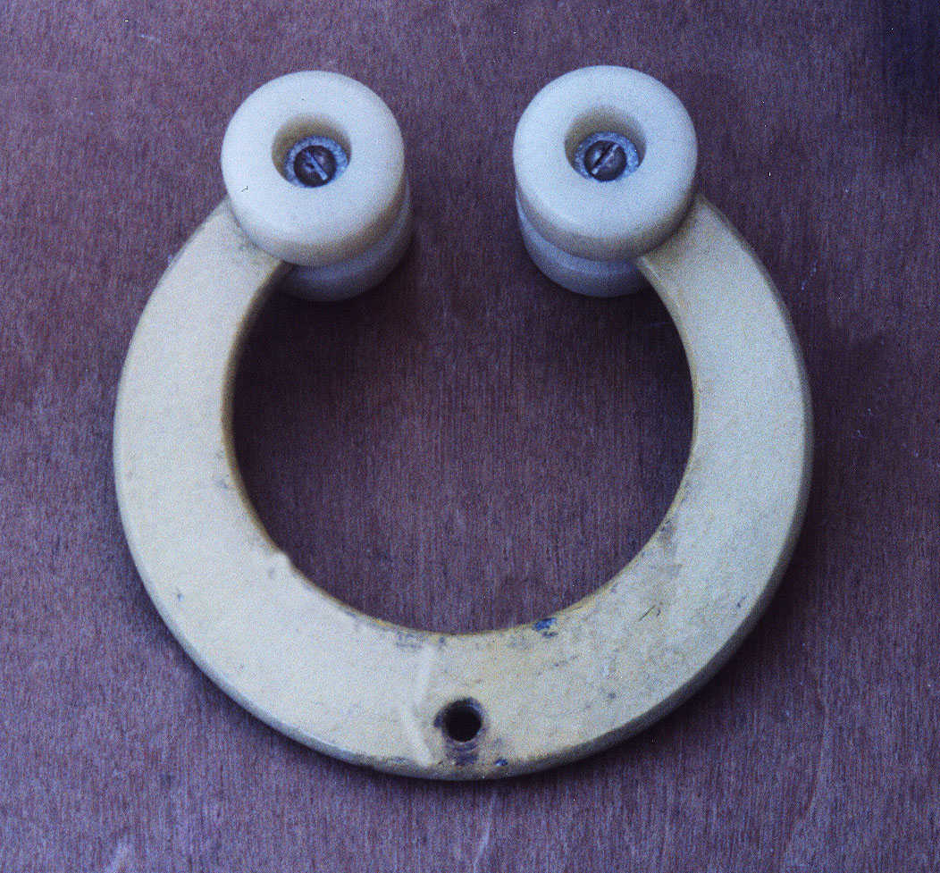

I used the reefing claw for the first few seasons before converting to slab reefing, the roller-reefing doesn't work too well! The boltrope on the sail tends to bunch up and prevent the gooseneck from locking in after you release it after rolling in the reef, so I had the sail partly unroll more than once. The sail rolled around the boom prevents use of a boom-vang, just when you need it most, in strong winds. However, my experience with the claw showed that it really doesn't try to slide forward or aft along the boom as much as you would think! tension of the mainsheet keeps it in place pretty well, even on a broad reach or run, one secret if I recall though is to carefully let out the sail as you change from a close reach to a broad-reach and then run.. keeping tension on the sheet helps hold the claw from sliding.
After all the above reasons that the roller-reefing "doesn't work well", let me admit that it sure beats not having any reefing option!! If you are buying a new sail soon, I would recommend ordering that sail with reefpoints and then setting your boat up for slab or jiffy reefing. but, in the mean time, although the roller-reefing was far from what I had hoped, it DOES WORK to a point, I wouldn't spend the money to convert your present sail if you intend to get a new sail soon. I used the roller-reefing and claw for 3 seasons before finally converting to jiffy-reefing (slab-reefing). The big advantage that you presently have is actually having that claw! To try to buy one now will run about the same cost (or more?) than converting to reefpoints ($60-100+). I sold mine for around $25 after adding reefpoints to my sail.
THE CLAW
Reefing claw In use
Roller-reefing Claw pic.JPG (11.76 KiB) Viewed 6708 times
