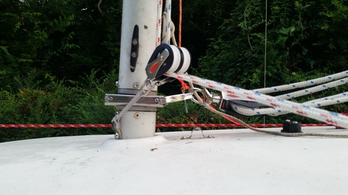

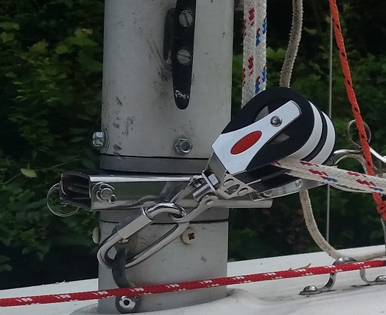

Postby jsbowman6 » Mon Jul 11, 2016 9:41 am
Talbot, the RONSTAN SERIES 40 AP double block only can be rotated to 2 positions by taking the stem pin out and moving it, that's one reason I added a SS chain link in the mix, but may try something with more flexibility. I'm thinking of taking the blocks stem pin out and seeing if the corners got rounded off if the block would simple rotate. I took the boat out yesterday and the halyards stayed put, that main is still hard to pull up. I need to drop the mast and look at what's going on. A lot of the friction is in the goose neck on the boom, it seems to bind in the sail slot, the other issue is when the main is 3 to 5 inches from the top, I think the splice is entering into the pulley and with that part being stiff, the main binds.
So here's a question that comes to mind: how high should the boom be relative to the cabin roof or sail slug entry slot? I may be trying to get the sail too high.
Carl, I've used a dry silicone spray in my sail slot and even squirted each slug as I put it into the slot. It helped a little. Not certain what you mean by "How is the line that supports the end of the mast set up?". If you mean the forestay, it's about 2/3's riveted with a strap to the mast and has a quick disconnect lever thing on the bow.
If I had not had an O'day 22 that was very easy to hand pull the mainsail up and cleat off the halyard, I guess I would just accept how hard the main is to deal with on this one. But I've made it better, just gotta figure out the details. Another thing I need to look at are the pulley sheaves, I replaced them with DR Marine ones and the ones they sent did not have a 1/4" bushing in them like the originals. (I'm still wondering if this mast is original).
RONSTAN SERIES 40 AP BLOCK DOUBLE.jpg (120.46 KiB) Viewed 15033 times

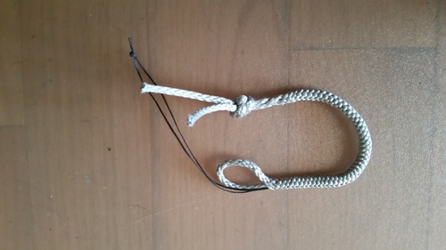

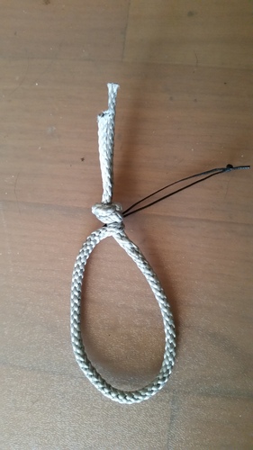

Postby jsbowman6 » Sat Jul 16, 2016 9:19 am
Well, I changed the SS chain link repair shackle for a soft shackle made from Amsteel to give the block more flexibility. Making it was surprisingly simple. Talbot mentioned it to me, so I watched a few youtube video's, took a piece of heavy gauge wire (electric fence) and bent it in half to make a fid. Splicing the eye was a very simple task compared to double braid.
Comments?
soft shackle.jpg (82.28 KiB) Viewed 15016 times
jsbowman6
Posts: 52
Re: 2 questions
Postby talbot » Sat Jul 16, 2016 1:06 pm
Slick. Especially the home made fid. I think you earned your merit badge.

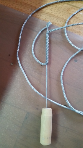

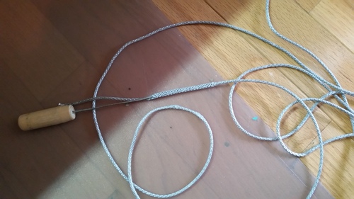

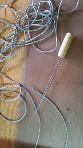

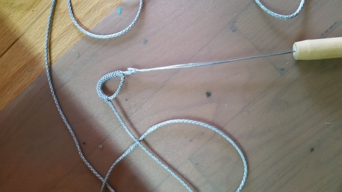

Postby jsbowman6 » Sat Jul 16, 2016 6:40 pm
Since this is for a merit badge, here's some more pictures :wink:
Anyway as Greenlake said this Amsteel is a breeze to work with. It's real slick or slippery, so you have to do special knots, I haven't graduated to that yet, but there's a very nice design for like a soft shackle that you can take apart or kind of a soft carabiner. https://www.youtube.com/watch?v=BFcxuNL37x8
The thing I made was inspired by this video https://www.youtube.com/watch?v=xcoKeXAwBZY. I only improve slightly on his fid design by adding a piece of dowel rod for a handle.
The Splicer Fid
1 splicer.jpg (68.18 KiB) Viewed 15009 times
Fid Inserted in Amsteel
2 splicer inserted.jpg (55.59 KiB) Viewed 15009 times
Fid ready to pull Amsteel into itself
3 splicer ready to pull.jpg (55.34 KiB) Viewed 15009 times
jsbowman6

Re: 2 questions
Postby jsbowman6 » Sat Jul 16, 2016 6:42 pm
Here's a picture of the fid done with the pull.
Fid done with pull
4 splicer done.jpg (49.29 KiB) Viewed 15009 times
