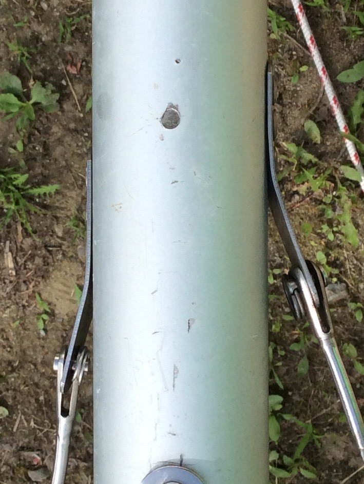

Postby fatjackdurham » Fri Jul 28, 2017 9:27 pm
I put the mast up for the first time today and found the mast lean to port sharply. Then I noticed the shroud straps....
I am really starting to wonder about this boat. Btw, how high above the cuddly deck is your mast opening? Mine is about three feet up. I fixed it though.

Postby TIM WEBB » Fri Jul 28, 2017 11:01 pm
Now there's something you don't see every day! Is there evidence of holes where one (or the other or both) of the tangs may have been previously, and possibly pulled out?

fatjackdurham wrote: Btw, how high above the cuddly deck is your mast opening? Mine is about three feet up. I fixed it though.
What do you mean by "mast opening"? Do you mean the place where the sail is fed into the sail slot? Mine is less than a foot above where the boom stop is. And the boom is about a foot above the deck. Something like that.
And what do you mean you 'fixed' it?

Postby fatjackdurham » Sat Jul 29, 2017 9:30 pm
Yes, the opening where you feed the sail.
Since this boat shows so many signs of serious damage that was repaired, I am guessing she had some kind of accident. I don't think this is the original mast. In fact, I am pretty sure the boat was salvaged, or cobbled together. It reminds me of the boats we had at summer camp. So many had collected over the years, parts, masts, booms came and went. Each year we put them together until we had enough to have sailing class.
I fixed it by drilling out the rivets and re riveting the strap on lower down. I used stainless 3/16th rivets and it was all I could do to pop them.

Re: Mast leans to port... there's your problem
Postby GreenLake » Sun Jul 30, 2017 12:20 am
Stainless rivets really need a beefier tool....
If you don't want to race the boat in a DSA sanctioned race then it being a bit of a "Frankenboat" would not matter, as long as it sails well.
