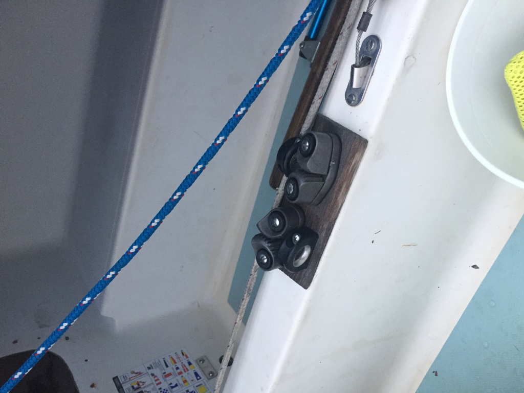

Here is the way mine is set up. The cleats are screwed into the CB truck with 2-2 1/2 inch stainless screws. I don't recall any metal backers, but it has been a couple years since I replaced those cleats.
I have raced and sailed her pretty hard without ratchet blocks on my jib sheets and they haven't ever come loose.

Mooka, is the wood block in your install just a spacer or riser?
