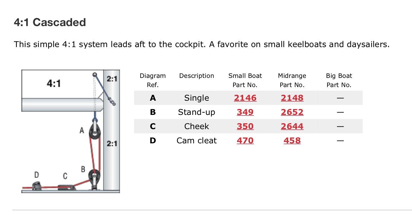

Found this diagram on the Harken web site showing a 4:1 setup. I understand Harken sells hardware, and was wondering if this 4:1 setup is “right” for a DS1?
Also the diagram shows the line attached to the mast. Any advantage to attaching to the mast rather than to the boom?
I’ve got this “mystery” green line coming out of a hole on the bottom of the boom and thought I might get rid of this green line, start the Cunningham line here, up and out the cringle, to the single block marked “A” on the Harken diagram.
Appreciate any thoughts / comments.

Thank you all for your responses.
LOTS of good information and thoughts... It will take me a little while to decipher it all and maybe draw out some sketches.
John thank you for adding the Harken part numbers!
Tom so your goose neck must be on a track for the boom to be pulled down the mast track? My gooseneck is fixed to the mast. I have seen using the ad hoc solution described in my post that I do get some wrinkles in the sail, at the foot of the sail along the boom near the tack.

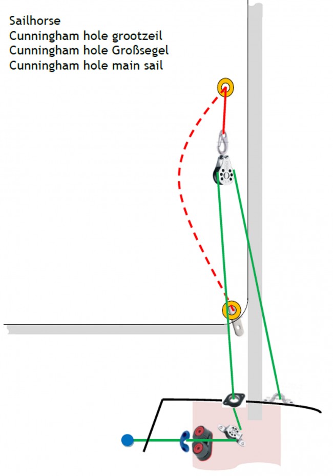

Let me see if I'm understanding you correctly. You have your cunningham rigged up like so (this is also how I had mine before I went to a boom downhaul):
Cunningham
You are proposing to put a hook at the end of the red line and just hook into the cringle, not go behind the sail (dotted red line)? I can see the advantage of being able to use it as a reef hook - I'm assuming you have a reef cringle higher up the sail and closer to the luff. Just swap cringles and pull. Is that what you have in mind?

Postby jalmeida51 » Wed Sep 11, 2019 9:30 pm
Tom I have set up my Cunningham different than your sketch. I have a block where I'm going to disconnect the red line from it. Add a reefing hook directly to the block and the running line will go down to a pivoting lead block with cam cleat. This pivoting block is attached to the side of the mast. All the hardware on the cabin roof on your sketch I will not need. I have 3 cringles on my main, Cunningham, 20% reef, 40% reef. ( luff ) I reef now by using a reefing hook on the gooseneck for the luff and a dedicated reefing line for the leech. It works but I would like to get the main flatter. Plus getting the cringle hooked on can be a pain. I talked with a sailmaker today and he suggested to use webbing with a D ring attached to the reefing cringles. This would make it easier to hook it to the gooseneck. This would solve that problem, but I still can't get the main flat just by using the halyard. Maybe I'm being too fussy about the flatness of the main.
