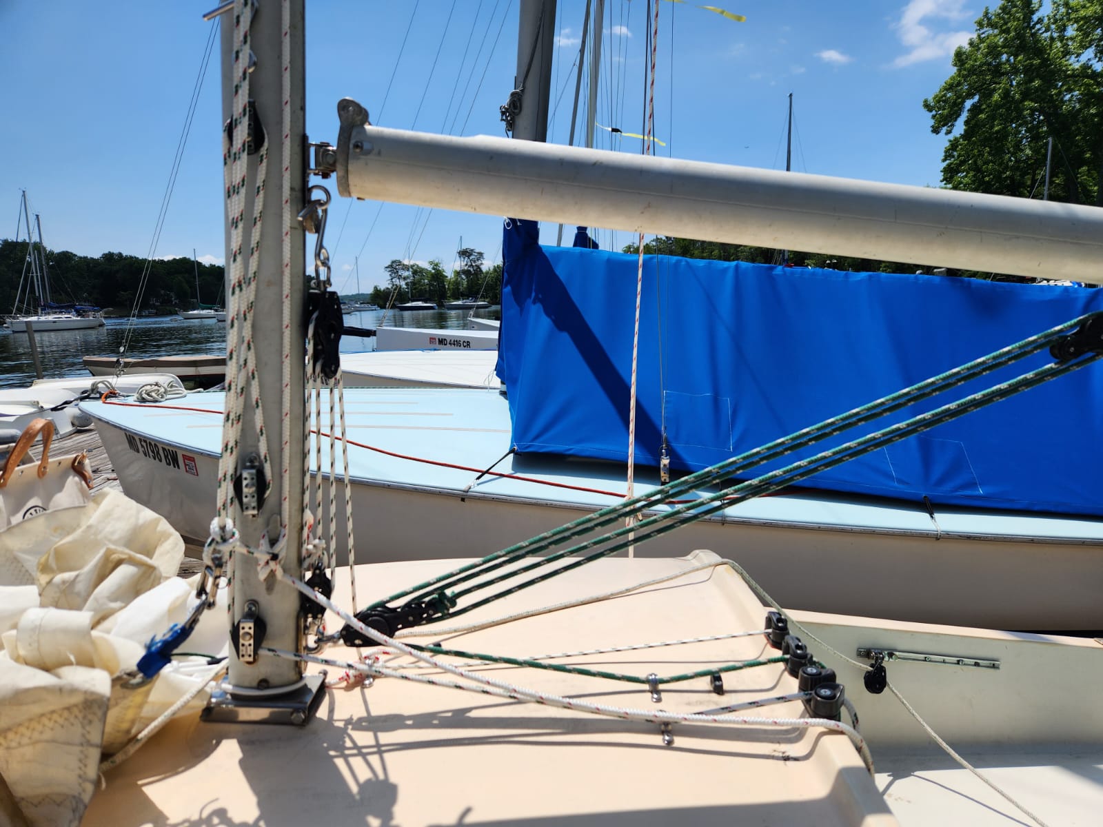

Postby pbobbitt » Sun Jun 04, 2023 4:52 pm
I recently bought my first DS. the guy that had it before me really wasn't a sailer, and had actually rigged it with clothesline. I think he bought it from an original owner who had it stored in a barn... the hull was actually pretty clean.
Attached, you can see how I've progressed in rigging my DS2:
The boomvang is the green line, pretty straight forward.
The downhaul/cunningham is attached to the same ring as the vang, I pulled the factory installed cleat to make room for the fiddle block.
The guy had wire jib, but no obvious way to tension the jib. I installed an additional cheek block, and then added a hook, with another block attached that I keep hooked to the padeye on the mast, until I need to crank it down, then put the hook through then alpine loop in the halyard to really crank it down. I'm pretty sure you can do this set up and still keep it class legal as long as it's below the boom?
I'm running all these controls through to cam cleats at the foot of the mast.
Weirdly the boat has never been rigged to have a spinnaker.

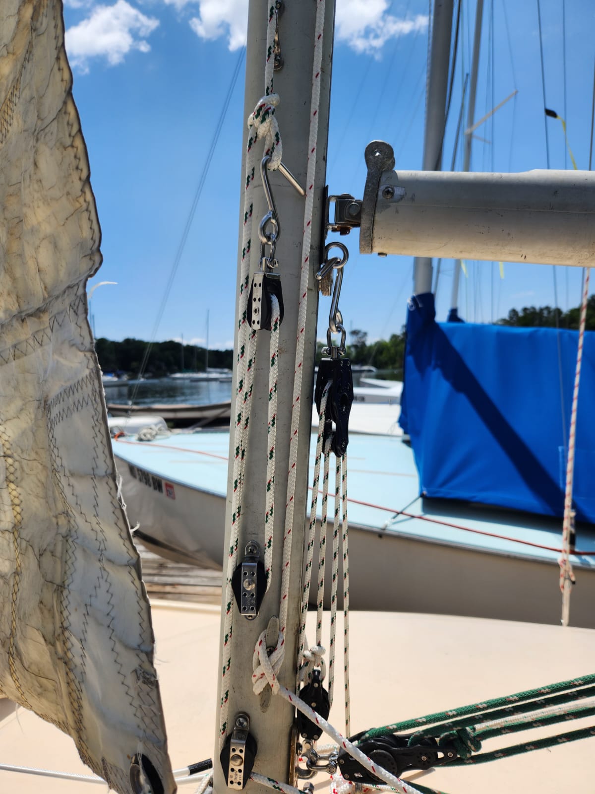

Postby pbobbitt » Sun Jun 04, 2023 4:53 pm
Jib tensioner detail... Note that the hook is now on the alpine loop in the halyard.

Postby GreenLake » Mon Jun 05, 2023 1:28 am
Thanks for the photos.
The rule about halyards in the bylaws refers to "halyard hooks and latches". A latch would seem to me like what bigger boats call a clutch, which is something like a cleat. The reason for limiting them to near the bottom of the mast is (according to my guess) that mounting one high eliminates stretch in the remaining halyard. A halyard hook is often used with wire halyards. You have a hook that's mounted on the mast (or an L plate with a slot in it) and you hook in the end of the wire halyard into that.
Again, the advantage of having one mounted high is limited stretch from shortening the halyard.
Perhaps our class measurer will pipe up here with a clarification whether your style of hook, while placed on a halyard, is or isn't technically a "halyard hook" in the sense used by the bylaws.

Postby pbobbitt » Mon Jun 05, 2023 2:49 am
I started sailing when I was 18, mostly self taught, reading books. In the last 5 years or so, I started hangin out with guys at a club that have been sailing/racing since they were 5. Rightly, or wrongly, they referred to this setup as a 'latch'. I have no idea if they were correct, all I know is that you can now get enough tension on the dang thing to sail it :D

Postby GreenLake » Mon Jun 05, 2023 5:12 pm
I usually keep an open mind about terminology -- there are so many usages out there. Even on our lake there are "dialects". And sometimes there are the distinctions between traditionalists vs. "moderns" with the latter tending to use updated terms for some items found on small boats that have a traditional name, but that to them doesn't feel right.
However, I just went and searched a bit. It looks like the terms "latch", "hook" and "lock" are used interchangeably for the same kind or type of device: it usually has some kind of slot for the wire and is intended to capture a ball swaged at the end of a halyard wire and to hold it in a fixed position. Functionally it works like a cleat or clutch, but it holds the wire by the swage, and not by using friction, and it is usually at a fixed position or has a small track to allow adjustments over a small range of then fixed positions.
In some boat designs these can be mounted quite high on the mast, but that's prohibited under the DS class rules. I can imagine that mounting the lock at the top reduces effective stretch, giving an advantage to boats rigged that way.
What you are showing is something different; effectively replacing part of the halyard with a purchase. I can see no inherent advantage in using a longer purchase, in fact, making it longer would add weight, and making it go all the way up would add weight aloft, where it's not wanted.
With these factors in mind, my understanding of that clause in the bylaws would not cover your application. But the class measurer would be the authority on that.
PS: I found the terms "latch" and "clutch" also used interchangeably, but unlike the other cases, not in the context of a catalog or website for selling hardware, and it seemed to be informal or minority use. Which means, I'm not 100% sure what the bylaws intend to say about mounting a rope clutch for the halyard. Also unclear from the existing language is whether mounting a V cleat half way up the mast, for example, is considered a "latch" or not.

Postby pbobbitt » Tue Jun 06, 2023 11:52 am
I agree, placing the purchase higher just burns rope and adds friction.
