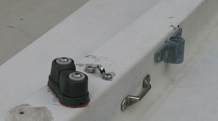

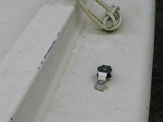

For my stern block on the DS II, I used a small cheek block with a spacer on the front to angle it up a bit to go to the cam mounted on the rail. I mounted a small cam on the rail with a loop to serve as a fairlead since the line diameter is small. See attach images. My friend David has been using a block attached to a loop, but has been having a problem with the block turning and twisting the sheet. He is switching to a cheek block as well. On the DS I the plan is to mount a cheek block in a similar manner as used on the DS II. For the cams, I recently bought original O'Day "new/old" stock spinnaker cams for mounting on the wooden coamings of the DS I. These parts are 50 years old and have never been mounted on a boat and cam in their original packaging from Schaffer.
Spinnaker Cheek Block.jpg (69.26 KiB) Viewed 15602 times
Spinnaker Sheet Cam.jpg (69.33 KiB) Viewed 15602 times
Spinnaker Cam for DS I - end.jpg (25.82 KiB) Viewed 15602 times

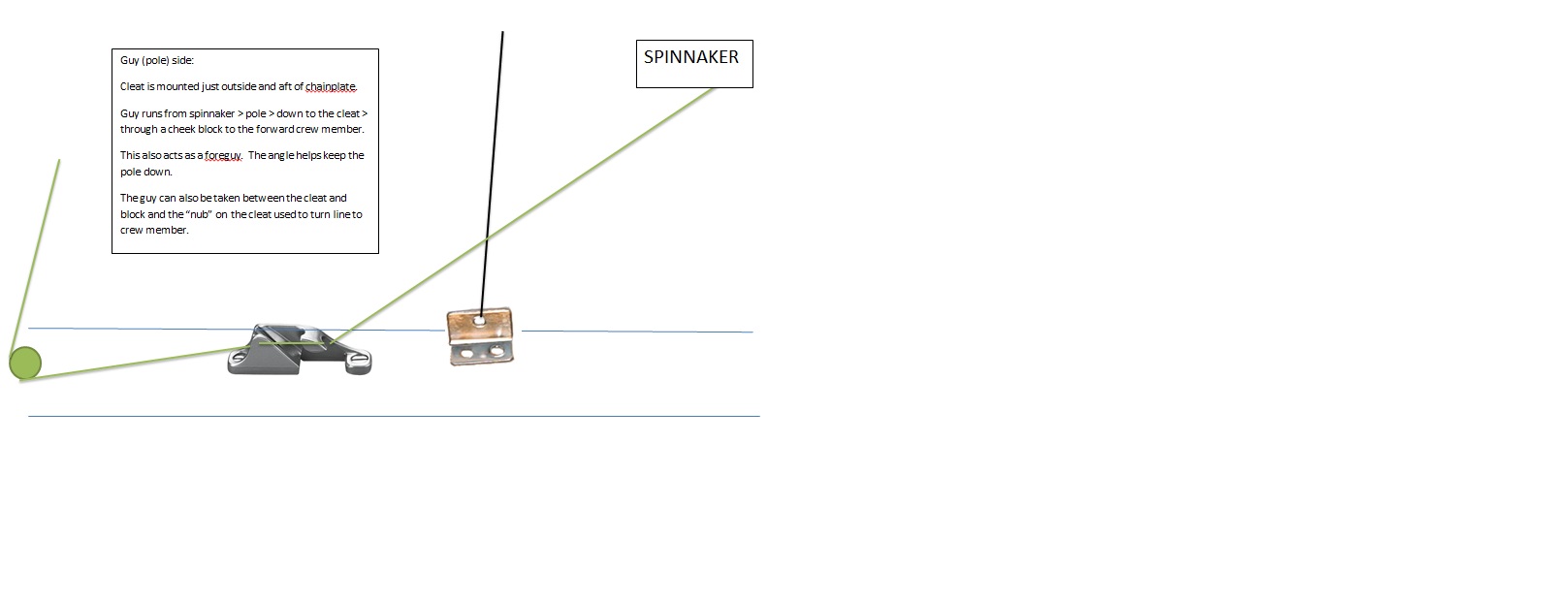

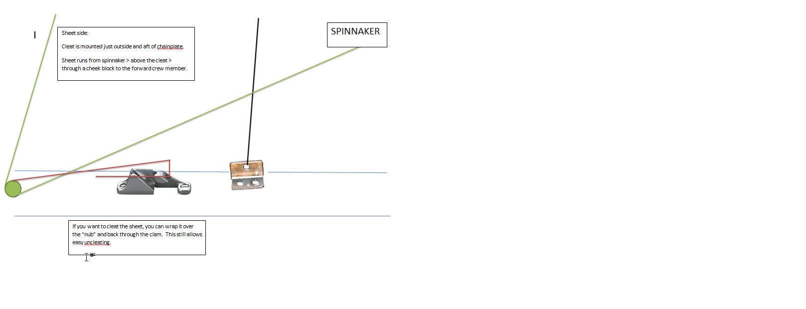

With the boat being covered for winter, you will have to deal with my awful MS Word drawings.
I chose to set up my cleats directly aft of the chainplates. This prevented me, or my crew, from ever having to sit on them.
Both pictures are from the water looking at the starboard side.
Spin Guy.jpg (68.19 KiB) Viewed 15596 times
Spin Sheet.png (68.89 KiB) Viewed 15596 times

MookaCB, is the round green circle the stern block?
Re: Spinnaker deck hardware
Postby MookaCB » Tue Jan 03, 2017 12:07 pm
It is a small cheek block. It is mounted flat to allow hiking.
I will be at my sailing club tomorrow evening and will see if I can get a picture.
