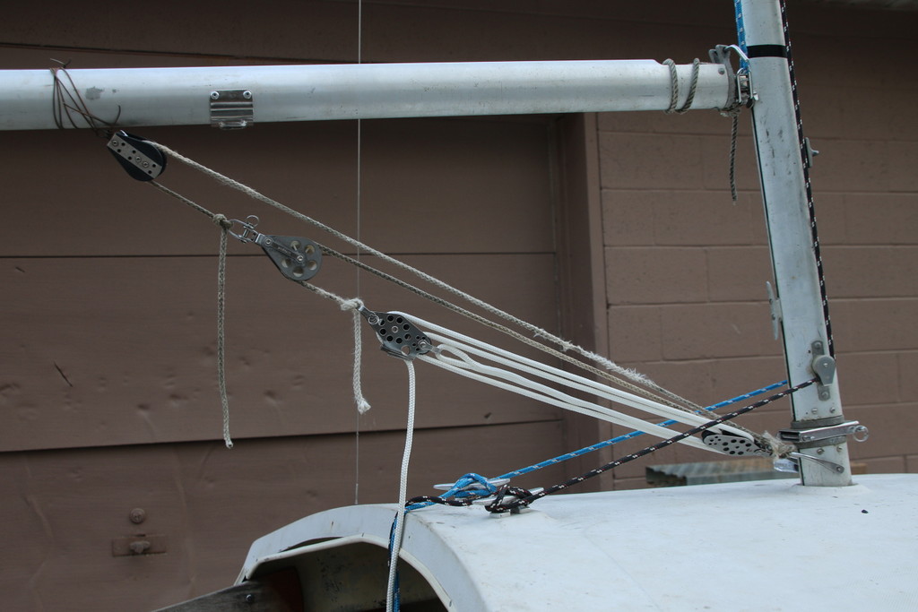

I agree about starting slow, just taking in info. think i have it.or at least getting the basics. you have a triple block (3) plus a double block (2) equals 5, the first cascade (x2) makes it 10, and the second cascade (x 2 ) gets you to 20:1.

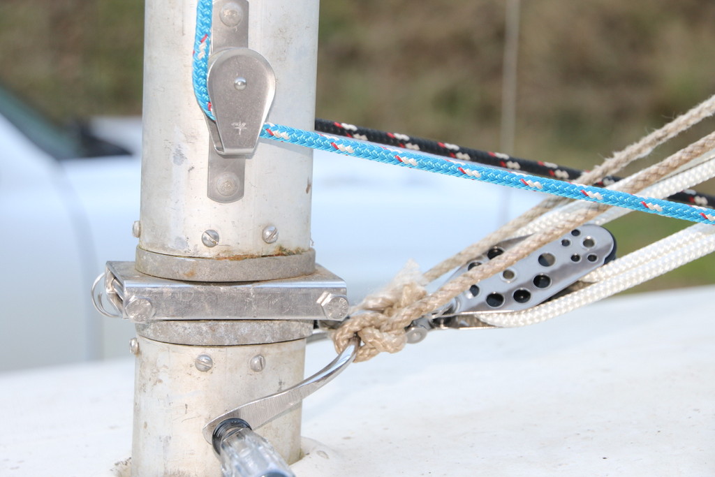

Postby Fly4rfun » Fri Nov 20, 2020 10:09 pm
Did a mock up today of the vang set up, defiantly see the issue with using the fiddle blocks. so will look for some double blocks, one should be a double with becket and cleat correct
also I have all the lines going to one hoop below the tabernacle. should i add another hoop above the tabernacle for the cascade blocks. It would go just below the cheek block.
GL fixed the photos

Postby GreenLake » Fri Nov 20, 2020 11:51 pm
Not sure what happened to your images. You don't need to reduce them that much, and it's hard to see what you are trying to show.
Mine go to the same U bail.
Eventually, you'll want to re-string a purchase w/o an integral cleat and set it up so the free end exits at the bottom. After that, you either cleat it on the top of the cuddy (at the edge) or you can drill a hole, run it down to the mast and lead it to the CB trunk and some cleat there. (This last option can be the final stage, when your skills have gotten to the point where you can work the vang dynamically -- initially, you might just change it for wind conditions and point of sail, not for every gust. But except for some trials, you'll get tired pretty quick with a vang that you need to pull towards the front of the boat to cleat and release).

Postby GreenLake » Sat Nov 21, 2020 4:25 am
I like the screwdriver!
(thanks for fixing the images).
Looks like you would have the length to use your existing blocks, but the problem is the cleat. If you look at photos of my setup you'll see that I had to turn the vang "upside down" so to speak, because of a built-in cleat that couldn't be operated if it was near the mast. (Couldn't get the angle). Otherwise, it's a very nice cleat. Some makers have the angle adjustable - I looked carefully at mine and didn't see a way.
The current setup puts the vang in easy enough reach for me to adjust it infrequently (not for every gust). As long as that suits me, I'll keep this setup. But in the back of my mind, there's the idea that eventually, I may have to lead the vang back to a cleat near where the mainsheet is cleated, so both can be operated in concert. When I'm ready for that, I hope I'll also have a better idea of precisely what the details of such a solution should look like in order to deliver.
That's why I suggested you might like an interim solution where the free end of the vang exits at the bottom and is lead to a cam cleat on / near the edge of the cuddy. If you leave the tail long enough you should be able to reach it from a single-handed sailing position. Upgrading that later to where you lead the tail down the mast, forward along the floor, etc. doesn't affect the rest of the setup much, except that you'd be "abandoning" one cleat. (Most likely you'll find something else to use it with).
