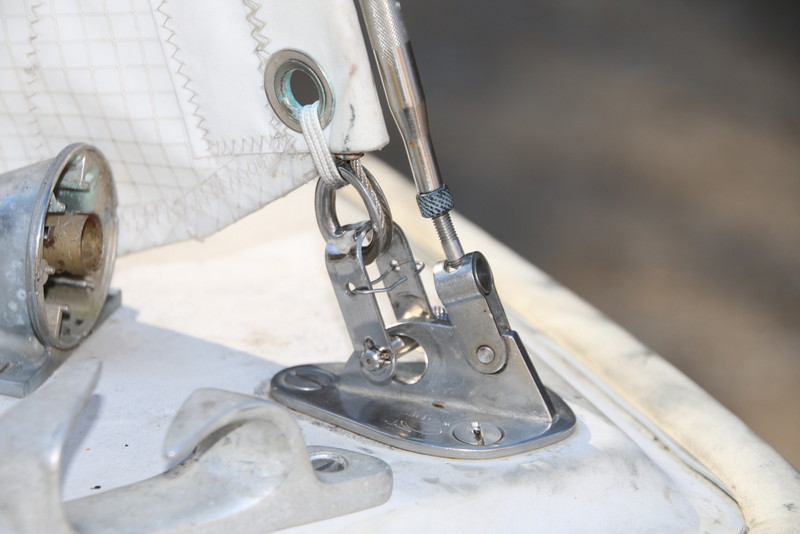

Postby GreenLake » Thu Dec 24, 2020 2:17 am
The tack would attach to the deck, but the first hank does not have to be at tack level, or does it?
Re: Proper forestay tension and mast angle
Postby Fly4rfun » Thu Dec 24, 2020 2:54 am
I think not as the shackle is what holds the sail to the stemhead, 1st hank is about 14 in above that.

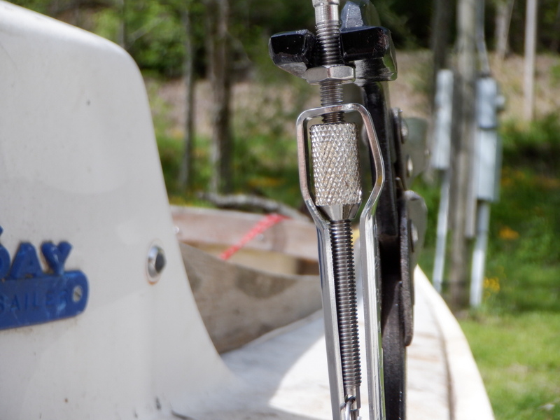

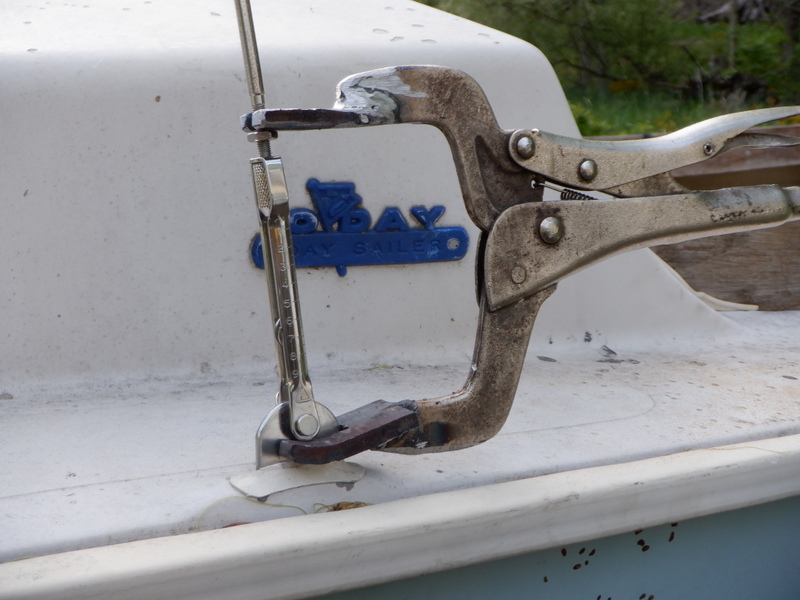

Ok, update on the install of the new rigging,
what I did was go back to the original foot location (actually 3/4 in more aft. It looks good, I have about 90lbs on the forestay, 150 lbs on the side stays, I took one of my welding vicegrips and modified it so i could take the pressure off the adjusting screw so I could add or remove tension, this was done with a Loos gauge on the stay. worked out great, not bad for 30 min of construction time.
this is the spacing obtained

GL,
I've mentioned that I like to putter and make things :P . To adjust the tension on the stays i would have to disconnect the fore stay so it would release the pressure on the turn buckles, this way i dont have to, this releases the pressure just enough to be able to turn the knurled screw that adjust the tension.
it worked better than i thought it would. stays are 1/8 from D&R with standard turnbuckles.

Postby GreenLake » Tue May 11, 2021 1:14 pm
Garry, there's a misunderstanding here somewhere. The first hank is not at the clew. So it (the first hank) can be a few inches above the deck w/o the foot of the jib having to also be that high.
Postby GreenLake » Wed May 12, 2021 1:48 am
There's a benefit to a "decksweeper" jib: it cuts down on or eliminates pressure equalization across the foot of the sail, making the bottom portion of the sail more efficient.
