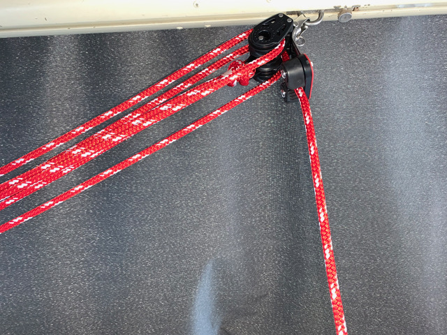

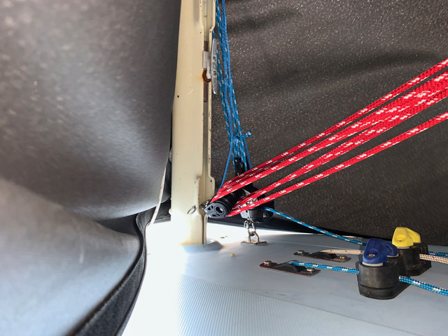

Just wanted to "finish" my part of this thread from last winter with what I ended up doing for my vang and add some pictures (we all love pictures) :D
The boat had come with a 4:1 40 mm Harken fiddle block set up for the vang. After many discussion posts last winter on both increasing purchase and having the vang cleat at the boom end rather than the mast end. I went with a 6:1 set up using Harken 29 mm Carbo-Air triple blocks (part # 2641 and # 2647) and used 1/4" sta-set line. Was happy that the it was easier for crew to make adjustments since cleat was at boom end and “cleats up”, but found that sometimes the vang line “fell out” of the cam cleat since the cam is facing down.
This summer still need to tweak the vang, maybe either flipping the the upper block around, re- reeve that block so cam faces up, or maybe just getting a micro cam fairlead over the cam on the top block that will help hold the vang line in place. May also add another set of blocks to double the purchase to 12:1

By falling out, you mean, accidental release of the vang? That's something we haven't seen with our setup, which is pretty much the same except the blocks would be Ronstan's equivalent to your Harken blocks/cleat.
Re: Vang questions
Postby RobH912 » Sun Apr 11, 2021 1:34 am
Yes line came un-cleated, line fed through the blocks and Vang tension lessened.
Maybe line was not fully up into the cleat... not sure.
Happened more than once.
Rob

Postby GreenLake » Sun Apr 11, 2021 1:00 pm
I've had my vang rigged like this now for more seasons than I can remember and never had that happen once.
The tail for my vang is short. No way to step on it, accidentally, for example. Because I have a cascade, the length of my 6:1 block and tackle can be shorter. It's only as long as needed for the required range of adjustments. That means the the bowline that connects it to the cascade is at a convenient place to loosely hold the end of the tail: I just push the stopper knot through the two legs of the bowline loop which are pulled taut and the tail is out of the way, but still allows adjustment.
Finally, you could have a non-optimal pairing between cleat and line. Although the dimensions are the same, we have different brands of cleats and the rope I use is also of different construction. Mine feels slightly rough and bumpy. It runs fine through the blocks, but is very grippy. (Check the "Rope for various lines" thread, I probably document it there).

Postby RobH912 » Wed Apr 14, 2021 1:00 am
I actually think this may be an issue, as with the limited times out last fall I never got to trim the new Vang line. Not long enough to step on, but too long / extra line weight pulling out, combined with the line is now in the way of crew moving side to side on racks.
When I get the boat rigged in several weeks I was going to check on line length / trim the line.
