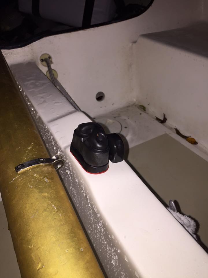

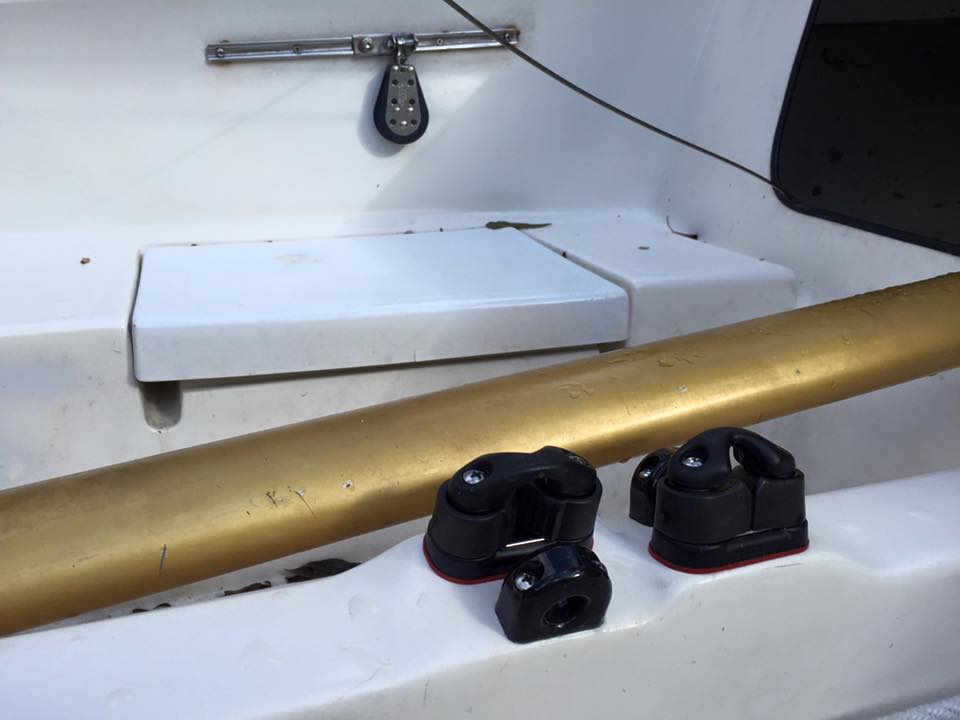

I have completed the Main and Jib sheeting systems (at least version 1). I am still working out something for the boom vang, but will try and sail this weekend and test the current changes. Here is what I ended up doing...
The jib cars got recycled 2.25" Harken Blocks. They were free (my buddy gave them to me), so for now they will do. I think that West (Worst) Marine has a sale on the Ronstan 40mm auto ratchets for around $35 or less a piece and then there is a Black Friday Coupon for another %15 off, so I am keeping my eye on that deal :D
I ended up doing a fairlead and cam cleat combo on the centerboard trunk (facing at a downward angle) for the jib sheets. The fairlead ensures the sheet pulls down first and then allows it to follow upward, either through the cleat or over the cleat, to the the normal "sitting" position(s) angle to pull back out toward the edge of the boat. Depending on a slight variation in the vertical pull angle you can hold in hand or pull and cleat from any position. I tested un-cleating and can do it from the transom corners of the boat, in which I doubt will ever be a necessity.
For the mainsheet, I used the Harken 144 swivel cam cleat with a 57mm Harken fiddle. On the boom is a 57mm Harken auto-ratchet. The swivel cam solves the auto-cleating problem by reversing the un-cleat mechanism to an upwards pull. Again, you can hold the main sheet in hand or pull and cleat with a slight change on vertical angel.

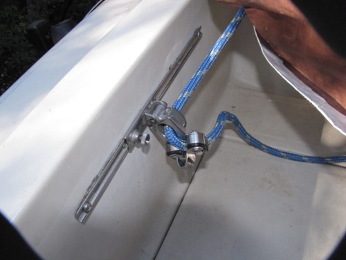

Gonna have to do this in two posts, since we're only allowed three attachments per, so here goes:
I've got a lot more respect for the stock DSII jib sheet cleat/fairlead hardware since I figured out how it's supposed to work.
You can handhold the sheet, but if you need to cleat it, you do it like so (port side shown, top of photo is toward the bow):
stock jib sheet cleat - cleated (resized).jpg (129.24 KiB) Viewed 18350 times
and if you're single-handing, you can let it drop, like so, while you hold the mainsheet and tiller.
stock jib sheet cleat - cleated (2) (resized).jpg (126.98 KiB) Viewed 18350 times
But let's say you need to let it loose in a hurry (next post) . . .
Re: Mainsheet setup and Purchase System
Postby Alan » Fri Nov 27, 2015 12:28 am
. . . all you need to do is reach over with the free hand you just took off of (probably) the mainsheet, and grab the free end of the jib sheet . . .
stock jib sheet cleat - uncleated (resized).jpg (125.36 KiB) Viewed 18353 times
. . . and give it a good yank; out it comes, and when you drop it, the jib flies to the wind and you're free to do whatever else you need to do to keep from capsizing.
stock jib sheet cleat - uncleated (2) (resized).jpg (120.5 KiB) Viewed 18353 times
That said, I've installed a whole new design (swivel cam cleat) on top of the coamings, mostly because my crew likes to lounge in the corners where the stock cleat/fairleads used to reside.
