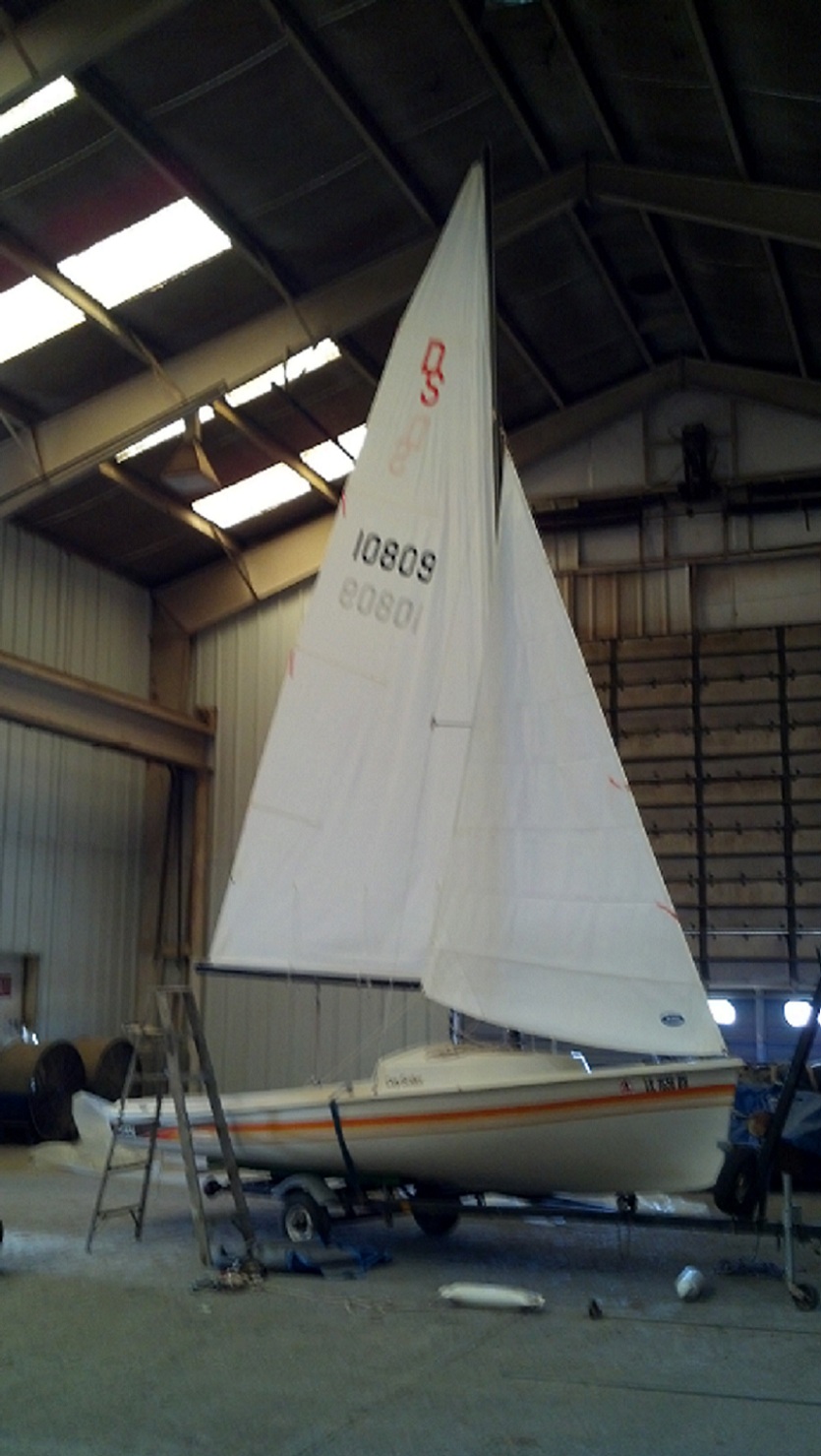

I rigged my boat up and looked at it and pulled on the Jib halyard and did not get much movement. I think I will be able to shorten the track a little.
Salty Dog
Posts: 173
Location: Canyon Lake, Texas
Re: Jib halyard tensioner
Postby Salty Dog » Mon Mar 25, 2013 11:32 pm
yikes I did something wrong!! Its huge. That thing gotta be a 40 footer.

I was going to sail my boat as it is for a while and get used to how it handles. Then I will be able to tell what the additions do for me. It is my understanding from reading this site that to tighten the jib halyard will help with pointing and loosening it will help with running off the wind, and being able to do it from the cock pitis a plus. The barber in haulers will help with pointing as well. The down haul on the jib will secure the jib to the deck without going forward. I also plan to add some of those noodles to the floatation. I thought that sounded like a good idea. This is all I am going to do at present. I figure that it is the cheapest to do for now besides changing sails and foils. I am also under the impresion that the DSI is a better or faster boat than a DSII. As I am the owner of a DSII and I have desided to race in the Wurstfest Regatta. I am going to practice and and add these few adjustments to help me not to come in too far back. Mostly though I just plan on haveing a lot of fun.
I am also going to replace the halyards. Mine are a little weather beaten and I thought that would be a good addition.
ChrisB Yes It is great to have a Brother-in-law with a big building he isn't using. :D Down side is it is 5 1/2 hrs from the lake. :( Oh well you can't have everything. :D
