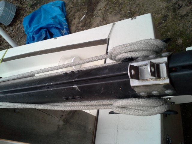

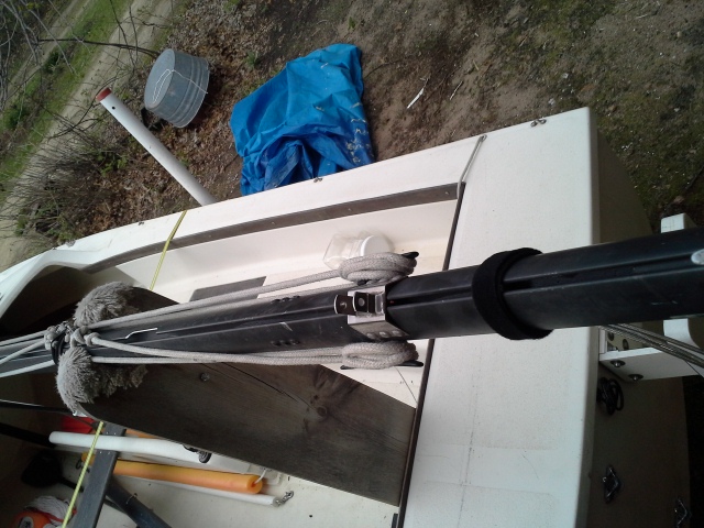

I just bought a 1983 spindrift daysailer, everything looks pretty straight forward except for this one bracket. it's on the mast below where gooseneck slides in and above the downhaul cleat. I'm assuming its for some rigging thats long gone. If it isn't for anything I want to take off because it gets in the way of the downhaul, but I would like to know what it was for first.

This is for attaching the boom to the mast in a fixed position. Eliminates the need for a downhaul. Luff tension is controlled with a Cunningham.

Thanks I'm new to sailing, I never would have thought of that. To use that setup, would I use just the outhaul for tension on the foot of the sail rather than running boltrope for the main sail in the track on the boom and tensioning with the outhaul? The cheek blocks and cleats at the base of the mast aren't used in the setup the po had. Can then use one of those for the cunningham then?

Whether or not the boom is in a fixed position is independent of whether you fly the mainsail as a loose footed sail.
A mainsail that is cut for use with bolt-rope will usually have a "shelf" at the foot. Some extra material that allows the "belly" of the sail to extend down to the level of the boom (without the shelf, it would have to curve in sooner to meet the straight line of the boom). A loose-footed sail usually will not have the shelf and may have extra reinforcements (or an integral sail slide) near the clew, as the back of the sail is held at only one point.
If the sail is designed for use with bolt-rope, I'd tend to use it that way.
Many DaySailers have a sliding gooseneck, which can be pulled down by a downhaul. If your sail has a Cunningham, then as Roger described, you don't need to move the boom up and down to change luff tension.

I get it. I didn't remember seeing the extra grommet a little higher above the tack on my sail, i looked again its there. What are the pros and cons of running it with a cunningham? Can I run the lines like I mentioned previously if I decided to use it? The po was using it with a sliding gooseneck, but I can see the bracket getting in the way of that.

You answered my question, I just was curious how to rig it, I only mentioned the out haul because of my confusion with loose footed sails (mine is actually MIA). I did some looking around and answered my down haul vs Cunningham question. I don't think my boat is rigged for a spinnaker but, hey I'm new to this so there's a good chance I'm wrong. The way it was setup when I got it, the main and the jib halyards are cleated directly on the mast on a pair of horn cleats. There are two cheek blocks mounted on either side of the mast just above the the mast step hinge, that as far as I could tell are weren't used. There is the bracket that I asked about and the another smaller horn cleat below it that I assumed was for the downhaul. The boom is using the sliding goose neck. There is a ring on the front of the mast but I just assumed it was for the whisker pole. The jib sheet is run through a pair of swivel cam cleats on either side of the cuddy. Like I said the outhaul is missing, and the main sheet is run through a end boom traveler setup, though the rope traveler doesn't seem to have any adjustment.

You can use the cleat for the cunningham. (I use it for cunningham and downhaul, because I never adjust my downhaul). The bracket. If it really doesn't fit your boom, I would remove the bracket, and use a downhaul attached to the gooseneck to pull the boom down to a stop a the correct height. Then add tension as needed by Cunningham.
