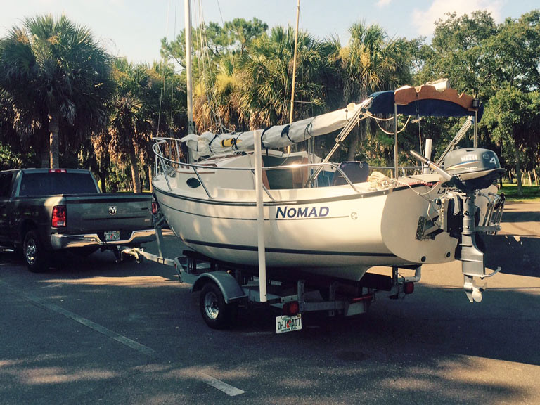

Postby TIM WEBB » Fri Aug 21, 2015 10:59 am
I've never used one of these myself, but the founder of the West Coast Trailer Sailer Squadron bought a Compac Suncat that had one on it. He had nothing but trouble with it, something about the end always jamming in the track I think, and he's removed it altogether. Not much need for it anyway since the boat also has one of those wooden arch spar support thingies on the stern:
