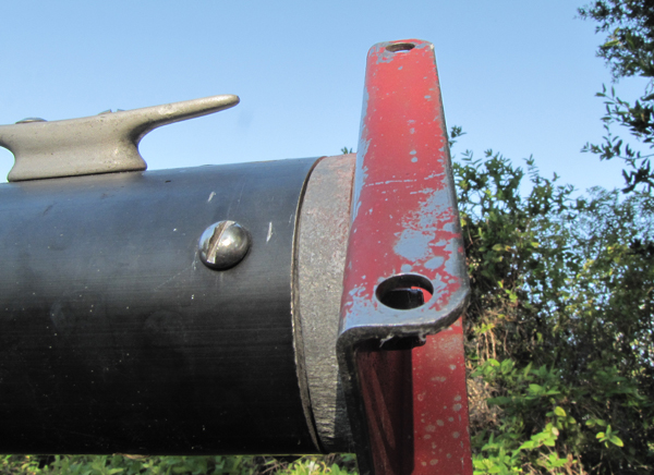

Postby Alan » Wed Jul 13, 2016 7:02 pm
Here are some photos of my setup:
This is how my boat came.The slotted screw in the photo is one of two that secured the casting to the mast.

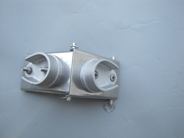

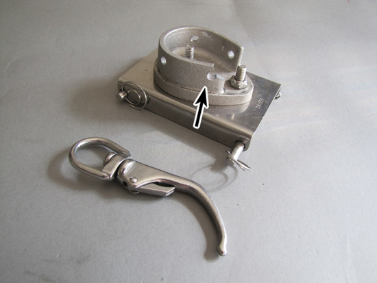

I bought a new hinge and castings just for peace of mind. Here are two views, both taken before I drilled the castings:
mast hinge 2.jpg (185.19 KiB) Viewed 21603 times
mast hinge 1.jpg (136 KiB) Viewed 21603 times

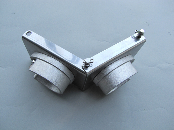

Postby Alan » Wed Jul 13, 2016 7:06 pm
damaged mast step and forestay shackle.jpg (154.58 KiB) Viewed 21603 times
I drilled and tapped the new castings for machine screws, then ran the mast into a powerline. Three of the screws stripped out of the top casting and the fourth broke part of the casting away. That piece at the bottom is the snap shackle that was securing the forestay to the stemhead.
Anyway,this should give you an idea of how the hinge and castings go together. If a casting is stuck, the mast may have been distorted by damage, or maybe it's corroded. Or maybe someone thought bonding it in with 3M 5200 was a good idea. :wink:
