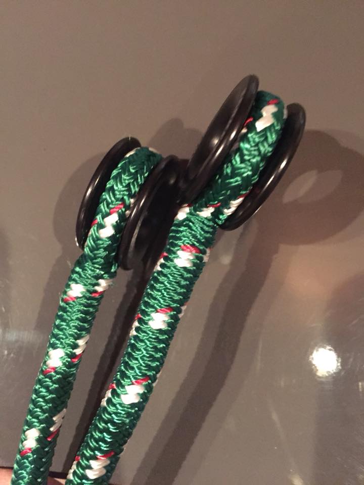

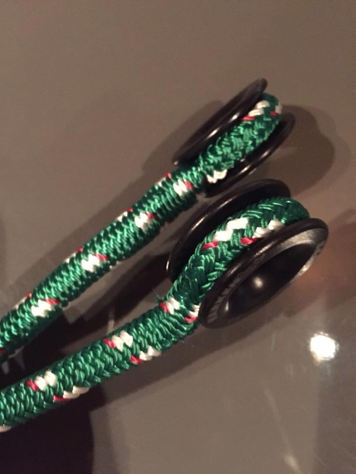

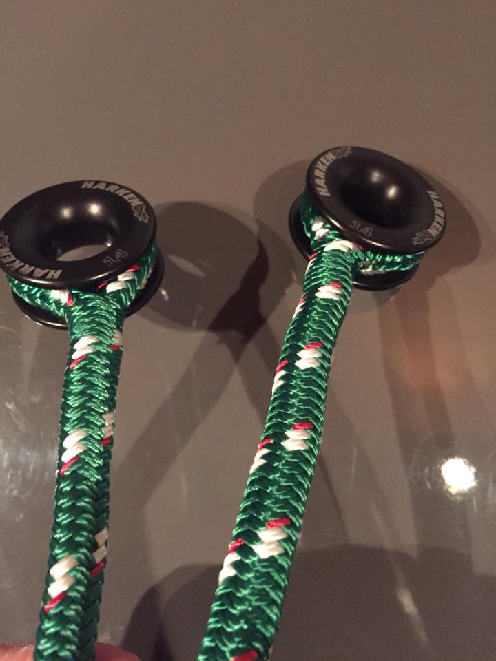

For fun, I cooked up this idea to make a "twingy" type Barber Hauler vs the ol' block on a string that I have mostly seen. Actually, to be honest it is probably more about having fun expanding my knowledge of working with rope. Anyway, my conclusion is that the Barber Hauler does not need to necessarily have a block, just a low friction orifice for the jib sheet to pass through. Here is what I cooked up. I am pretty proud of myself on the rope work, lol. Thoughts?
It is a 1/4" braid w/ a long bury eye splice around a 14mm lead ring. I wanted to use braid, because dyneema only lasts about a year on my boat in the Florida sun. Its looks like crap in a matter of months. The braid is much more UV resistant, and I expect the load on the barber hauler line to be relatively low. Thus I expect to not have to replace this very often.

Postby GreenLake » Thu Sep 21, 2017 9:28 pm
Your rope work looks nice.
I've long suspected that rings would have been a better option than the blocks I used (at least I used some that are all plastic, so they are slightly less likely to bang up the deck). Your rings should do better on that count.
However, I had someone on the forum who I respect very highly state that in his view rings had too much friction. I'm wondering whether we ended up talking about the same thing, because for an in-haul, the angle that the sheet gets deflected by is very small (and friction grows exponentially with angle, that's why you can hold or even stop a big yacht after taking one turn around a dock cleat). So, with something less than 30 degrees, the potential for friction should be much reduced compared to the usual 90 or 180 degrees for which we ordinarily use blocks.
My prediction, and let's see whether your experience bears that out, is that these will work fine for the purpose. But if you see them binding a bit instead of sliding along the jib sheet as you trim your jib, let us know.
Finally, I'm not sure how serious UV degradation of Dyneema is, even in Florida. There are a couple of issues. One is that the UV will attack the outer surface first, and therefore it will affect the way the rope looks. The second is that Dyneema is almost always overdimensioned - you should look up how little diameter you need to lift your boat. Because of that, the reserve strength is going to be enormous - and the application in question is pretty lightly loaded, in the 10s of pounds, not 100s (let alone 1000s).
I would suspect that even crappy-looking Dyneema rope would still be up to the job for a long time, and of course it is super easy to splice. However, splicing double braid, while a bit more involved, or because of it, gives you a nice feeling of accomplishment, and your work turned out very neat!

Postby DigitalMechanic » Thu Sep 21, 2017 10:32 pm
Thanks! I was pretty impressed with myself doing this with braid. I think it turned out well. I just need to mount and use them now. As for friction, without a trial, I cannot see how the lead ring would cause unnecessary friction unless the rope it was attached to was twisted pretty bad. The lead rings I have used seem pretty slippery. Also, would a block not provide some level of friction as well? With the light load on the foresail sheeting I feel like the friction situation may be a case of tomato vs tomato? Only a sea trial will tell?
As for the dyneema, I was not meaning to comment about it strength or longevity. No doubt about it excelling there. However, It literally looks like poo after a few months, and gets really crusty feeling. I had it on my boom vang. Not really friendly on the hand once it turns... On a boat this size, and considering my level of OCD for aesthetics, I have to at least give the braid a go :wink: I think it will stay "aesthetically pleasing" much longer.

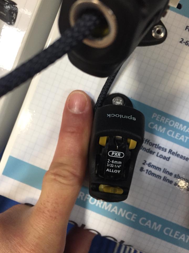

These little guys to be exact... http://www.apsltd.com/pxr-single-3-32-1-4-alum.html?fee=5&fep=30131&utm_source=Google+Shopping&utm_medium=cpc&utm_campaign=Product&gclid=CjwKCAjwxo3OBRBpEiwAS7X62cMIk-jqd4C3zIezwjpz8F3FJclDdMkKe-2-4uhlqNSCiHebVc5JLRoCEYYQAvD_BwE
Here is a picture of their size...

Postby DigitalMechanic » Fri Sep 22, 2017 8:04 am
I do not have practical use with them, only a little fiddling with one at the store. But the PXR series is considered a cam cleat. I can confirm that you pull up to release and down to set. You can always pull line in when engaged, just like a traditional cam cleat. Spinlock’s Big selling point on the PXR is that it is easy to release a heavily loaded line. As for the case of the barber hauler, that is probably moot point. I was looking at these more for their small footprint, dual fairlead/cam in a single device, and ability to combine a swivel, all in a package the size of my finger. They are definitely “captive” cleats though.
I figured I would mount on top of the cuddy near the aft edge, each leading from opposite side of the boat to the sheet. One problem I can think of is that if the sheet runs free and is flapping off the side of the boat, and the barber hauler line runs completely out of the Spinlock device, it would be more challenging than a cleat to to run back through it. In theory this should not happen if locked, but anything can happen right? Lol
The alternative to the Spinlock would be to have an angled (45 degree) fairlead where the spin locks would go, that lead out to a cam on the backside of the cuddy near the outer edge. This would allow the spare line to drop into the front corner of the seat.

Postby DigitalMechanic » Sun Sep 24, 2017 11:10 am
The Spinlocks are $36 each and done. The micro cleats are $26 each plus add onthor $5-$6 for a fairlead? I think that makes a cost differential of $8 between the 2 proposed options. But I am not really on the fence about the cost difference at $8 bucks. I am more trying to figure out which is more functionaly desirable.
Spinlock:
Pros - presumably tidy, small footprint in busy area
Cons - Can only place in one spot, all inclusive lead/cleat device does not allow extra options on where to terminate the tail.
Camcleat/Fairlead:
Pros - The “Tidy” aspect is controversial, at least in my head right now. I would place the fairleads on the back of the cuddy deck, and then lead the tail of the line out to the edge of the cuddy deck to cleat off and let the tails fall into the corners of the seats. This should make access while hiked easier. Not sure if adjustments while hiked is needed/desirable, as the barber haulers would be new to me. None the less, if my head is in the right place on this, the footprint in the busy area is reduced to 2x little fairleads.
Cons - A little extra line will be required. Not really a big deal.
