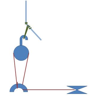

The next stage, in a still partially jury rigged setup will be a Prusik loop around the halyard (so I don't have to tie any knots in it) and a simple 2:1 purchase with a hook. The Prusik loop can stay on the halyard (it can be moved around if the front of halyard needs to be lowered to deck level, and moved back into position for the tensioner). The halyard can be belayed as usual, then the tensioner engaged for additional tension as needed. Right now, I'm planning to use a spare deck fairlead as both attachment point for the standing part and fairlead for the working part of the tensioner and then to cleat it off on some unused horn cleat on deck. (Later, it may get a dedicated cleat).
Here's a really crude diagram of what this would look like (it does not show the halyard tail being cleated)
The one piece for this I need to finish is a continuous loop I can use for the Prusik loop (green).
With the halyard cleated as normal, there's no need for using a shackle; the somewhat more insecure hook should be fine - if it pops out, the jib just reverts to lower tension, and doesn't come down altogether. And I'm hoping that this will add very little to the setup time, in that the tensioner stays on the boat and doesn't need to be de-rigged.

Postby tomodda » Fri May 24, 2019 5:50 am
Will the prusik go thru your jib halyard block when you lower the jib? Yes, it's soft, but is there any danger of jamming?
