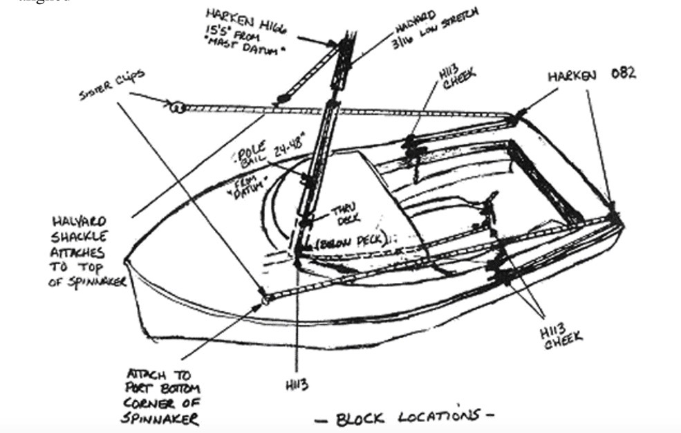

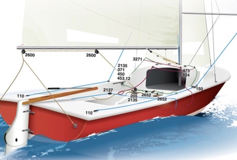

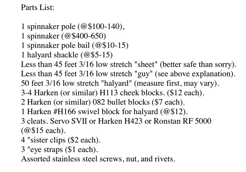

GL After several searches decided to add my post to this thread. Feel free to move it if not right spot.
DS1 #2444 has never been set up for a spinnaker and I am trying to get a better understanding of the rigging diagram & associated hardware that may be needed. I am meeting with a Rigger at a boat yard next week to talk about the work, store the boat there for the winter, and have them do the work if I decide to move forward.
Found a couple of sources of DS Forum and a "newer" source on the Harken site for DS deck layout:
http://forum.daysailer.org/pdf/qtr_spin ... er2001.pdf
https://www.daysailer.org/Rigging-Guide
https://www.harken.com/DeckLayout.aspx?id=50141
Looking at the list & location of equipment from the 2001 article and comparing it to Harken diagram and list have a couple of initial questions.
- The older rigging shows a two small blocks on top the transom H082 vs. newer diagram has Harken 110 blocks which are through deck blocks so that the spinnaker line runs forward underneath. Is that a preferred way to run the lines?
- Spinnaker lines run forward then pass through another block directing line back aft for crew or skipper to control spinnaker. Hard to see but in the 2001 diagram it looks like a H113 cheek block mounted on the deck aft of spreaders. Harken diagram calls for using 110 through deck block then forward to a 57 mm Cheek Ratchet Block. Also hard to see from Harken diagram but looks like their block is mounted on the inside of cockpit/on side of wood trim) rather than on the deck. I'd prefer deck mounted rather than side of cockpit from primarily a seating POV but don't know if functionally it would be better to have this block inside the cockpit of not?
Seems like if I go the newer harken 110 through deck blocks I end up needing to have the next set of blocks internal, if I go with the older H082 rigging set up I can keep the cockpit cleaner.
I will be doing a lot of sailing without the spinnaker and don't want to have a block in someone's back when we are just out for a sail.
Any thoughts or comments always appreciated.

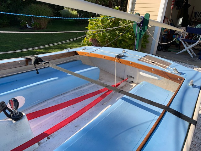

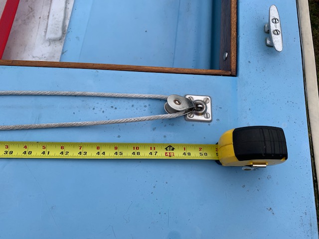

Postby RobH912 » Thu Oct 10, 2019 12:48 pm
The other thought I've had is that maybe I can put the rear spinnaker blocks where the two rear cleats are now. The cleats are both coming off.
It is forward of where I think the spinnaker blocks would normally be placed, but the block would help cover up the cleat holes / also be mounted on the raised part of the deck.
WDYT?
