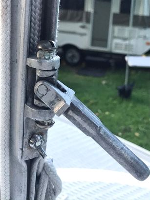

I'm now the proud owner of a 1970 DS 1 and I've taken her for a couple shake-down runs on pretty low-wind days... Had a lovely time of it and am now working my way through the few issues that have revealed themselves before bringing her into any real wind.

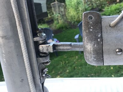

The current one that has me scratching my head is the gooseneck (I'll see if I can add some photos here). I was surprised to find that it isn't firmly attached to the boom... which means that the boom isn't firmly attached to the mast. Is this normal?
There's a pin/rod protruding from the mast-slide part which starts as a square and then tapers to round closer to the tip. This fits in a square shaped hole in the end of the boom. Reading the old DS 1 manual it appears that the gooseneck was designed to allow one to reef the main by pulling the boom out a bit (to the round part) and then furling the main sail around the boom. Do people do this? Also, when I look at the goosnecks sold by D&R for the DS 1 they appear to have spring internal to the boom... I'm wondering if mine isn't just incomplete.
I'll stop there for now... but as the topic header implies I also have questions about boom-vang, down-haul, and/or cunninghams... none of which are present on my boat and I'm wondering if I need (any of) them. I'm guessing the boom-vang at least would help keep my boom snugged up to the mast?

Jon, I think you put your finger on it. The roller reefing around the boom would require a "reef claw" so you can attach the mainsheet to something when the main is wrapped around the boom. If your boat didn't come with one you can be pretty sure that nobody used this feature on your boat (and anecdotally from reading along on this forum, it seems very few people ever did).
With the sail firmly attached and the outhaul under tension, the boom won't go anywhere. The spring you mention isn't very strong (I may have pulled on mine once or twice out of curiosity). So I'm not sure that there's any immediate concern - as you suggest you could always rig a vang, that would really jam the boom against the mast. Having a vang is not a stupid idea for its own sake. I've held off from installing one for the longest, but now I really appreciate how you can use it to help depower your main: the vang will bend the mast, which pulls the middle of the sail flat, but it also puts tension on the leech and keeps the boom from rising as you let out the mainsheet. That maintains the flat shape of the main, even if you are not fully sheeted in, so you can let out the main to depower without the loss of shape undoing part of the effect.
You would need to rig something stronger than the 3:1 stock vang (which was ever only intended in keeping the boom low going downwind). I rigged a 6:1 with a 2:1 cascade, others have gone up to 20:1. You can search the forum for suggestions. Anyway, if you install one of those, your boom really won't go anywhere.
If you like the ability to reef the sail, put a slab reef in. Again, widely discussed here.
As for rolling the sail to stow it, I just put mine into a tight roll and keep it next to the boom (when parked - foot of sail in boom groove) or tied loosely to the boom when docked somewhere for a while, with the boom held up by the halyard. Not really any more work than trying to wrap a sail around the boom.
You would need a boom downhaul if the gooseneck can slide in the mast track. Yours seems secured with a screw. In that case, you'll have to tighten your main with the halyard. I do have a Cunningham for my sail, but it isn't always clear to me when and how to use it. Some days there are obvious wrinkles near the mast and adjusting the Cunningham fixes those, but there's less of an obvious pattern to it than I would have expected, so I don't feel I've mastered that one yet. Perhaps someone else can weigh in. In any case, you could watch for the telltale creases near the mast in the lower part of the main, and if, you could add a Cunningham - if your sail has the grommet for it (about 6" above the boom).
I'd say that of the items mentioned a vang might give you the biggest bang for your investment.

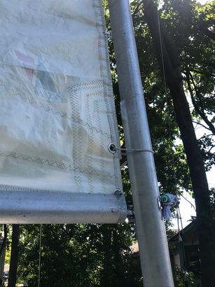

Unfortunately, the fist slide on the main sail is so far above the gooseneck that, even with the sail fully attached to the boom and the out-haul tight, I can still easily slide the boom off of the gooseneck pin. Good to know that the boom vang will help... In the meantime (while waiting for my vang to arrive) I'm making do by binding (loosely) the sail to the mast by adding a loop of line around the mast and through the cunningham grommet (I'm sure there's a real name for that). This configuration seems to answer.
Loop binding the sail to the mast.

Originally, the DS did not have sail slides; instead the boltrope on the luff of the main goes in the sail track. Some people find that cumbersome to use (I don't, particularly) and adopted a set of sliders instead; I've sailed on bigger boats where those are standard, but think they are overkill for the DS. But that's just my opinion. I sail with an eclectic bunch of small boat sailors none of whom are afraid of tinkering with their rigging, but none of them ever tried to retrofit sail slides. (The boats are all different, but in the size range of a DS). I guess, if kept on a mooring with the mainsail simply flaked to the boom and under a cover (like on the big boats), I can concede that it might buy you something over simply pulling the main out of the mast groove and rolling it. But for dry sailing?
Anyway, you do have the grommet for a cunningham, because that's what you are using for keeping your boom to the mast.
