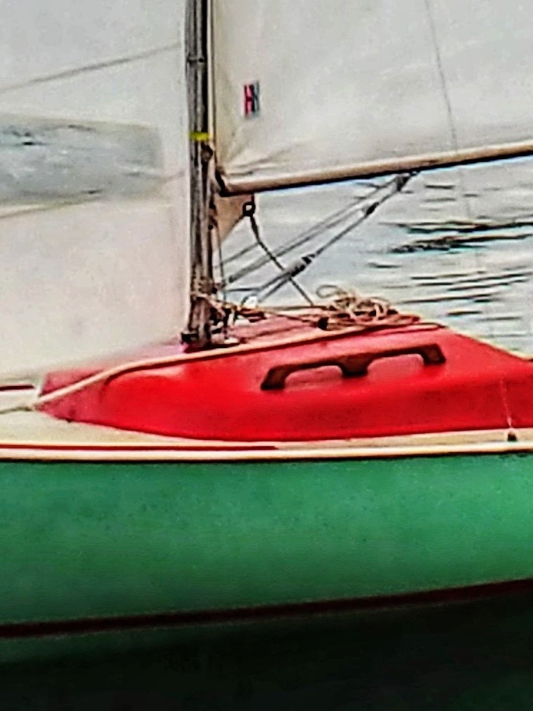

It's vexing. There simply seem to be no photos of my boat that show the full boom side on. . . Except one with a reefed sail covering any view of the vang attachment.
However, I think the location of the cleat towards the boom end is something like 12-18" from the cuddy edge (and the length of a becket + shackle gets added from there). Adding the distance mast-cuddy edge should give you a ballpark distance. You might also google to see whether anyone posts a suggested angle for a vang.

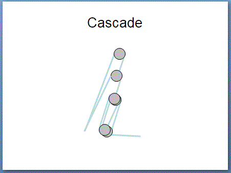

You do know how a cascade works? Anycase, here is a diagram:
A 16:1 dual cascade with integral 4:1 purchase
If the cascade needs to hold up to 500lbs (MWL), the outer block needs to be rated to that. The line running through it needs to be rated to 250 lbs as does the inner block. The purchase only has to hold 125lbs. (Because of friction, the purchase would need to pull with 150lbs or so to tighten the cascade when fully loaded, but that's in the noise.)
Now,I've used 500lbs as an example, but the vang is one of the most highly loaded pieces of the rigging. Assuming you can bring 50lbs of pull to bear on the free end, you'd get nearly 800lbs of pull out of your cascade (minus losses due to friction). That would argue towards using an outer block rated no less than 750lbs. That way, it won't come apart from you adjusting it...

Postby GreenLake » Thu Nov 19, 2020 12:45 am
The power of a purchase is the number of parts. (Here "part" is the nautical term for a separate piece of a line).
If you rig a purchase so the free end leaves the moving block (in the direction of its travel) you count the free end as a part as well. That's rigging your purchase "to advantage".
Each step of a cascade multiplies by a factor of two.
No higher math required.
PS: I fixed the diagram, one of the parts in the purchase needs to be tied off to some becket, so to show that schematically, it goes to the center now, not the edge of the block.
Re: Vang mount distance from mast
Postby GreenLake » Thu Nov 19, 2020 12:56 am
With the triple/double combo john should be getting a 5:1 and with two cascade steps he should be getting 5x2x2 = 20:1.
Mine is a 6:1 x 2 or 12:1.
I drew you a 16:1 in case you want to salvage your existing 4:1.
In high winds, mine may be a bit marginal, but there shouldn't be a word of difference between 16:1 and 20:1. (Less than the raw numbers seem to imply because of losses due to friction)

What you need to figure out is, given the length of the diagonal to a mounting point at 36", how much room is left between the tips of the fiddle blocks, given that you need to fit them into the diagram where I showed the pair of double blocks. (You'll loos additional distance due to boom bail, shackles etc.)
With an added 4:1 cascade, 1/4 of the distance between the tips of the inner blocks is the total range of travel for your cascade towards the tighter end. You'll want to be able to let the boom rise a bit as well, so you when you lay out the longest position, it needs to be a bit longer than required to just reach.
My suggestion would be to rig this up with parts you have, perhaps using knots, not splices, and do a test setup. I bet it'll become clear pretty quickly whether your existing vang can be incorporated, but, more importantly, independent of how you are doing the blocks, you'll be able to verify whether your ideas of the required range of travel for that vang will work out (including what length the vang should have at its "mid point").
The maximum length will be where the outer fiddle block and the two blocks of the cascade are all three chock-a-block (that is, effectively touch each other or can't get any closer). The minimum length will be when the fiddle blocks are chock-a-block (their inner end touch).

This is a 20:1 vang, like in GL's diagram above. I hope this helps illustrate what he's written about re; distances in the previous post. At max extension, the two cascade blocks (on top) will meet - this happens when you are at a dead run, mostly. Of course, you want a bit of vang tension even at dead run, so not that likely to happen. More usual is the two bottom blocks touching when you have the vang really cranked on, beating upwind.
