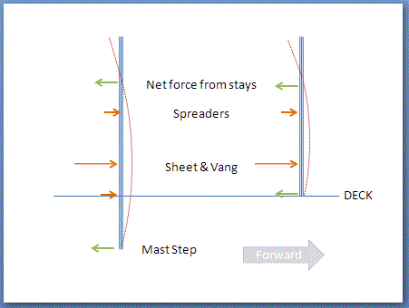

Tom, I thought a picture might save another kWord or so. Here is one that attempts to show the contributions from the various sources. Note that the drawing isn't to scale in the sense that the total forces shown in green must equal those in orange (plus the contribution from whatever the restoring force is from springiness of the mast). Also not shown is the net downward force from the stays, and upward force from the mast step/deck.
If the mast was bent much more, then the compression force would contribute to further bending the mast (by wanting to bring the ends together).
Showing forces contributing to mast bend
On the left you have your keel stepped mast. On the right is the deck stepped (tabernacle) version. The difference is that the area over which the mast bends is much shorter. The dashed red line is simply taken from an oval, but I made the oval shorter on the right. It's supposed to be indicative of how each mast bends, with the straight section on top.
The point in space where forestay and shrouds are balanced depends on their relative lengths and tension. In principle, it can be freely chosen as can the position of the mast step. That means the bent mast can be aligned with the mast partners so as to pass through with zero force, or, as shown here, with some net force.
The vang is off in this picture, but the sheet is on. What's the difference? The vang is usually attached to either the mast at deck level, or the deck. If the mast can't move, because of the tabernacle or the mast partners at deck level, then the entire force of the vang on the mast is taken up by the vang, leaving the contribution from the vang pulling on the boom.
Assuming a keel-stepped mast is set up so the mast partners push forward (mast rests against the back) the net difference for pre-bend is that the mast bends in a more shallow curve (and that an equally deep "belly" at the middle of that curve should take less tension to set up).

Note that if you search the web, you'll find claims for both the keel-stepped and deck-stepped to be "easier" for generating pre-bend. Only one answer can be right. Can it?
