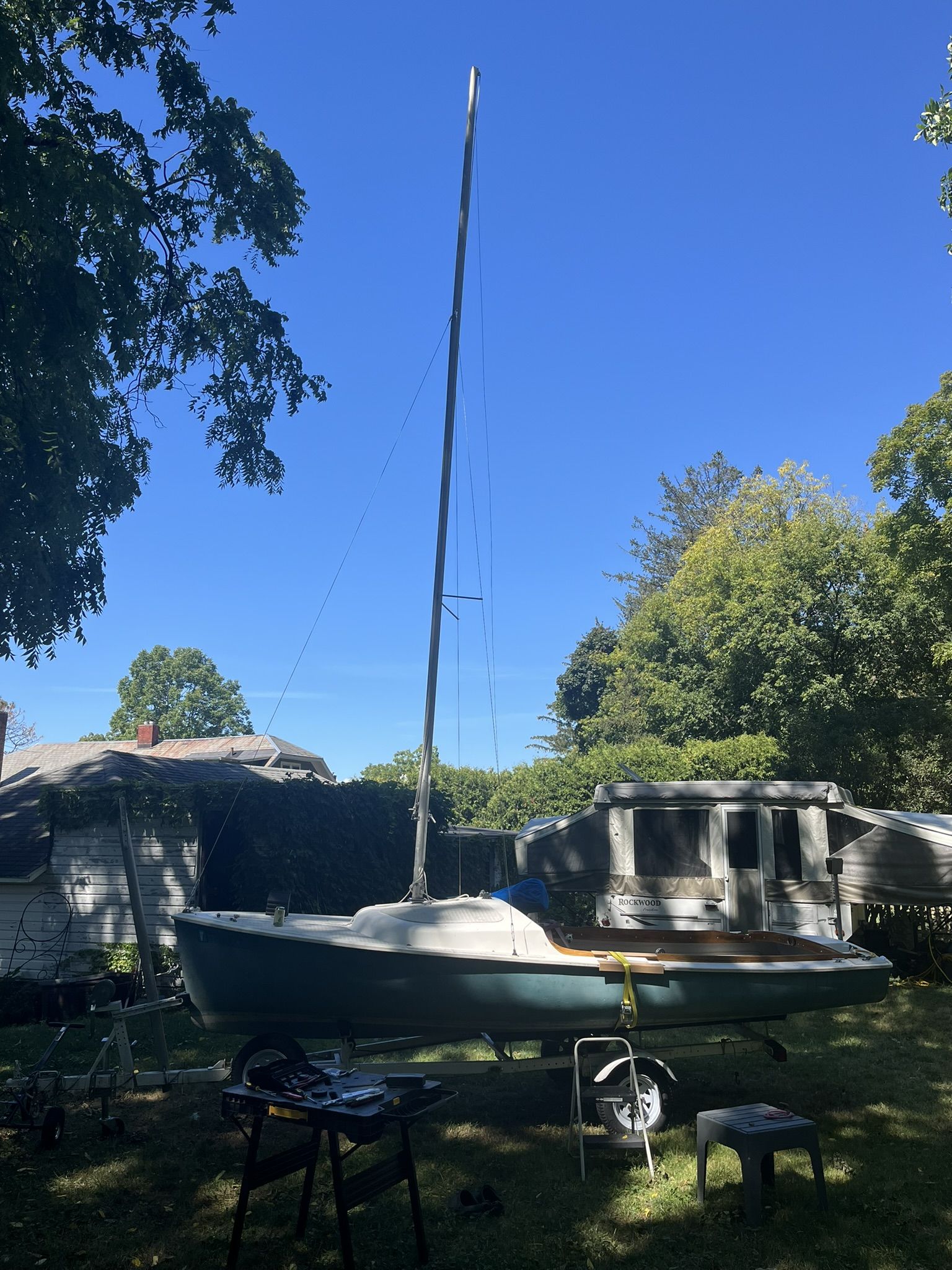

mast angle 1
I then purchased a couple of stainless steel O-rings and added them to the side stays. This added about an inch to each of the side stays, and the mast angle looks better to me.
Mast angle 2

1. How can I tell if I have the correct mast angle? I'm fairly sure that the PO didn't have the angle quite right... it always felt like it leaned a bit too far aft (but I don't really know that for sure).
2. Is it OK to add extra hardware (o-rings, shackles, etc.) to add some length in the shrouds (or forestay)? Or should I ask Rudy for longer standing rigging? Any idea what the expected working loads are for the shrouds? I see that the o-rings I have now are labeled "4,564 Pounds Breaking Strength", and "300lb. MWL". I haven't checked on the relative strength of other shackle options... but I'm wondering if I could find a captive d-shackle that would be strong enough.

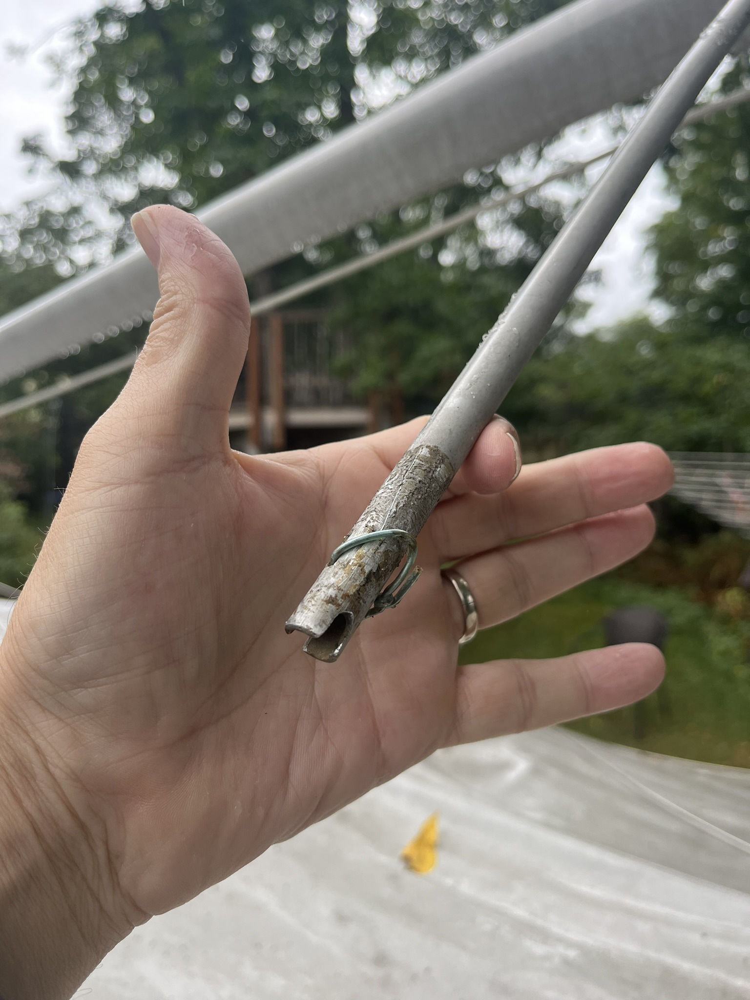

3. Seeing as my old shroud parted at the spreader... I'd like to avoid that scenario in the future. My spreaders are just tubes with a slot cut in at the end, and the shrouds fit in the slot and are trapped there by a wire tie. It seems like an obvious place for wear to happen. Is there something I can or should do to protect the shrouds? Wrap them in tape? or fit them through a plastic sleeve?
spreader 1

Spreaders: Those are fine as they are. If you replace your stays every other decade, you should not need to worry about coming up with a unique redesign of your very standard spreader configuration. Replacement should be somewhat more frequently the more exposed to saltwater and the more time exposed to variations in loads (like on a mooring vs. dry sailed). Visual inspection doesn't always locate any damage at the connectors / turnbuckles, so replacement "on spec" isn't a bad idea. Definitely the right idea to replace the whole set now (not just the failed one).
Instead of a simple wire loop, on my boat the wire is wrapped a couple of turns around the stay, both above and below the spreader. That cuts down on any movement. I then wrap the connection with self-amalgamating "rigging tape" - the white stuff that you stretch while wrapping and that really bonds to itself. This is more for protecting the sails.
Mast rake: Your mast should lean a few degrees aft. When your boat is floating(!) on its waterline, a weighted line from the mast top should be about 3" aft of the gooseneck. (That value is from memory.) A more accurate measure can be used if your mast has regulation length. In that case, you can measure the distance from transom to mast top (values can be found in the North Sails tuning guide for the DS).
There's another way to confirm you have correct mast rake. Sail the boat, and in moderate winds (moving well, but not hiking) you should need about 3-5 degrees of tiller deflection (pull to windward, or "weather helm") to keep the boat from rounding up, going upwind with sails trimmed correctly. Your boat speed should be around 4 knots for this test, not more. You would be sailing close hauled. At the angle of deflection you need, there should be some "feel" to the tiller, but definitely nothing that would feel forced. (That will come if you sail much faster and in higher winds). More mast rake will make the boat turn upwind more strongly, and vice versa. (See also the diagram and discussion in this post). If your boat doesn't round up, or even falls off, when you let go of the tiller, you are desperately short of the required mast rake.
(Mast in your image looks too straight. But it's impossible to eyeball when out of the water as boats never sit level on the trailer.).
