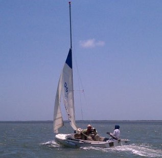

Rather than designing a whole new rig for the boat, you could just find a used mast the is shorter than the original. Put a hinge on it for easy raising. Put mast tangs and spreader brackets on the shorter mast in the same places as the full length mast would have so that the stays and spreaders are interchangeable with a full length mast. The standard working jib would still work. For the main sail, find a used main that is smaller that would be the same as a reefed main. A reefed main doesn't go all the way to the top of the mast. The boat should then sail like any Day Sailer with a reefed main. The shorter mast will be easier to raise. Keeping the full length mast allows the boat to be easily converted back to original configuration should you want to sell the boat in the future. Altering the whole rig might devalue the boat a lot. Just a thought.
Attached is a picture of my boat sailing with two reefs in the main. You can see how much mast is above where the fore stay and side stays attach.
Reefed Main - 2011.jpg (38.4 KiB) Viewed 35907 times
