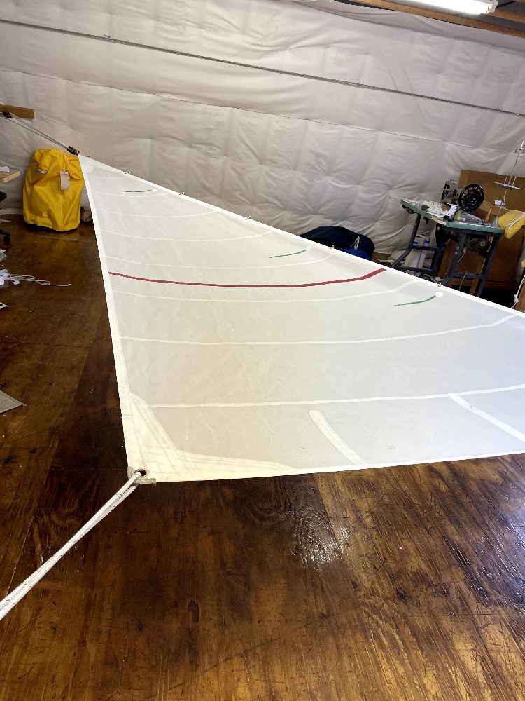

Postby tomodda » Fri Mar 26, 2021 11:42 am
Progress! Sails are done, should ship next week. Thank you for your suggestions, I went over them with Mike, the sailmaker, especially the idea of a single slug along the foot of the main. In the end, decided that the cost/benefit wasn't there for me. After much deliberation, decided to stay with a class-legal attached foot. Nevertheless, to my eye, I wound up with a pretty radical set of sails, very much looking forward to sailing with them.
Jib at Loft
Here's the jib, tensioned along the luff. The luff itself is a wire, rather than rope, and the jib can slide along the wire (it's fixed at the head only). And I asked Mike to give me the draft stripe. This all so I can use my jib halyard tensioning system to move the draft around, forward for pointing, back for power and light airs. I like where he set up the draft for "neutral" (how it sits here in the loft) and I'm looking forward to playing with it out on the water. In other news, he put three "darts" along the foot to eliminate fluttering. We'll see how that goes, I'm afraid of the foot somehow "cupping" vertically, but looks OK here:

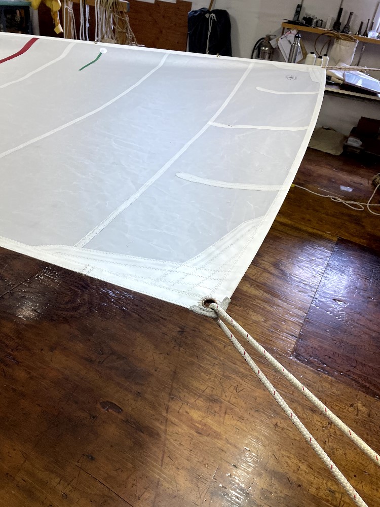

Jib Foot
I like the leather chafe guards that he's sewn in. The tack and clew rings are also hand-sewn rather than punched in. Nice touches. I like the "old school" triangular re-enforcement patches (rather than the 1/4 ovals people seem to use these days), let's see how they hold out in the long run.

Postby GreenLake » Fri Mar 26, 2021 6:47 pm
Draft stripes are something I'm missing on my sails and I wonder whether they would help me in discovering/fixing any bad habits in sail trim (or whether they'd just be yet another distraction). Any word on how to retrofit (and how difficult/expensive that would be?)
