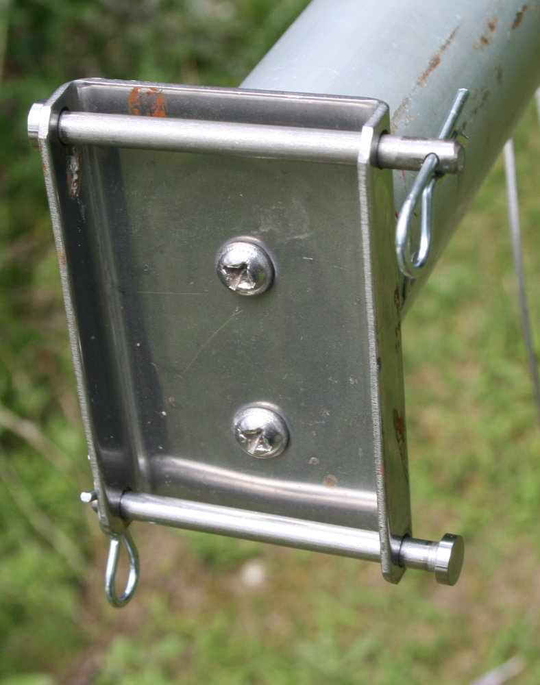

2)Made pins for the mast tabernacle. I got a couple 1/4" stainless bolts, and to cheer me up, put the on the lathe to turn the heads round. Cut off the threads, drilled a hole and voila!

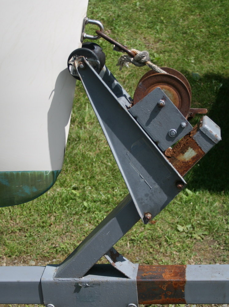

5) Adjust the winch pillar so that it's properly connected to the boat. It was too high and too far before.
THe winch
The pins
