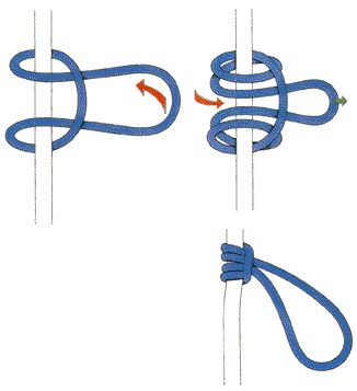

Ok, thanks. What is that kind of connection on your jib? it looks like you wrapped one line around the jib sheet. Why do it that way? It doesn't seem like it would slide like a self tacking jib, unless you have a traveler setup out of frame.

The "line wrapped around the jib sheet" is a loop that is wound around the sheet in a Prusik knot.
Prusik loop
However, in order to be able to disconnect the sail, the loop is cut, and one of the ends is an eye, and the other a bulky knot (Diamond knot).
There's a lovely site L-36.com that has instructions how to make "soft shackles", and that (or something similar) is what I am using for this loop.
A Prusik knot can slide, but only if it is unloaded (that is, you can push it manually up and down, but not pull it). Mine has not budged from its position in the middle of the jib sheet. I leave the jib sheet rigged, even if I take the mast down and the soft-shackle gives me a quick-connect to the sail. (You never want to use metal shackle there....because of flogging).
It is less bulky than having two bowline knots; I did not have to cut the sheet; and, finally, the sheet doesn't tangle as easily (my jib generally does not get hung up, even though I have lots of bulky stuff around my mast base.
Material: Amsteel from Samson rope - doing a splice in Amsteel is kid's play, but you need quite a bit of extra length for tucking. (When using a diamond knot for the purpose here, you trim the little tails flush, no need to have them out and whipped as shown in the linked image).
