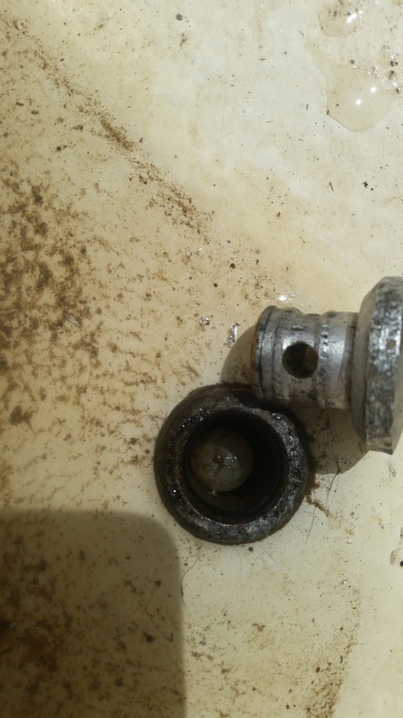

Well, I answered my own question with the help of Roger. In a effort to give back, since I found little on the web with pictures, here it goes.
This is a picture of the bailing plug, mine was rust colored when I started, but found it was aluminum (remember mine is a 1975, you mileage may vary), with the aid of channel locks, I twisted and pulled and it finally came out:
Note the holes in the side of the plug to allow water into the below housing:
Next is the plug pulled out and cleaned up, the best I could figure, there feels like an O-ring or something inside the hole, so the plug when pushed down seals and when pulled up stays. Not certain of that. There is a groove cut in the bottom of the plug, but I could not tell it had a rubber seal, so I wire brushed it clean. The inside of the plug has a bevel for the ball to float up to and act as a check valve in the case of the seal back leaking.......I guess.
I put my pinky finger into the venturi outlet hole underneath, or as it's called the bulb and pushed the ball up:
At least I'm not as scared of it. I'm going to find a 3/4" expanding plug

The bailer on my boat is complete and looks to be functional except that I'm missing the ball. Can the balls be purchased separately, or am I expected to replace the entire unit with a newer plastic one? Certainly someone has found something with a ball the same size that floats as an alternate source?

Most likely there is a better solution, but here's one idea:
https://www.widgetco.com/1-inch-cork-balls-agglomerated?gclid=CjwKCAiA0uLgBRABEiwAecFnk9uyFtDbd0N0cc3lNcxQIMLQy3djNBZzLK2tuJ7FpYn69Gy_gx8nzRoCrnkQAvD_BwE
Frankly I keep mine closed until I load it on the trailer. Not a big fan of the moving parts to keep me dry.

Mine was totally shot, so I picked one of these up from D&R. I haven't fitted it yet but it looks solid and no metal parts apart from the two pins that keep the ball in place. Looks like a super easy install too.
