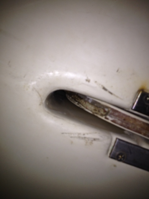

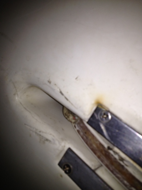

Last weekend I replaced the centerboard downhaul line with 5/16" Sta-Set. I did this without removing the centerboard from the boat. Since there is not a horizntal hole through the centerboard where the downhaul line attaches, there is no need to remove the centerboard to replace the line.
I very carefully drilled out the old downhaul line from underneath the boat. The old line had three clinching rings (hogrings) on it where it was glued into the vertical hole on the bottom of the centerboard. Since I could not tie a not in the 5/16" Sta-Set line and insert it in the hole, I crimped three hogrings on the end of the line with about 1" spacing between the hogrings. I used marine expoxy glue to secure that end of the Sta Set line into the hole in the centerboard, covered it with tape, and let it dry overnight.
The next day, removed the tape, and pulled the other end of the Sta-Set up into the boat, using a straightened coat hanger and some tape to pull yhe new line up through the downhaul line hole on the top of the centerboard housing. I secured the Sta Set line to the download block with three hogrings, and rapped those with rigging tape.

I attached three pictures of the new CB DH line, one in the cuddy cabin, and two underneath the boat. Please excuse tth pictures underneath the boat. One of the mistakes I made when I went sailing a week ago, was tryinng to beach the boat while waiting for powerboats ahead of me to return to the boat ramp. Turned out the bottom was muddy, not sandy.
I used 5/16" Sta-Set line, and Marine Tex Flex Set glue. I purchased both from West Marine.
