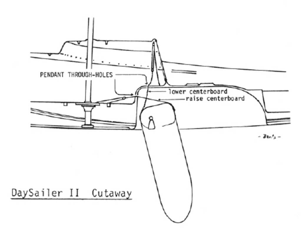

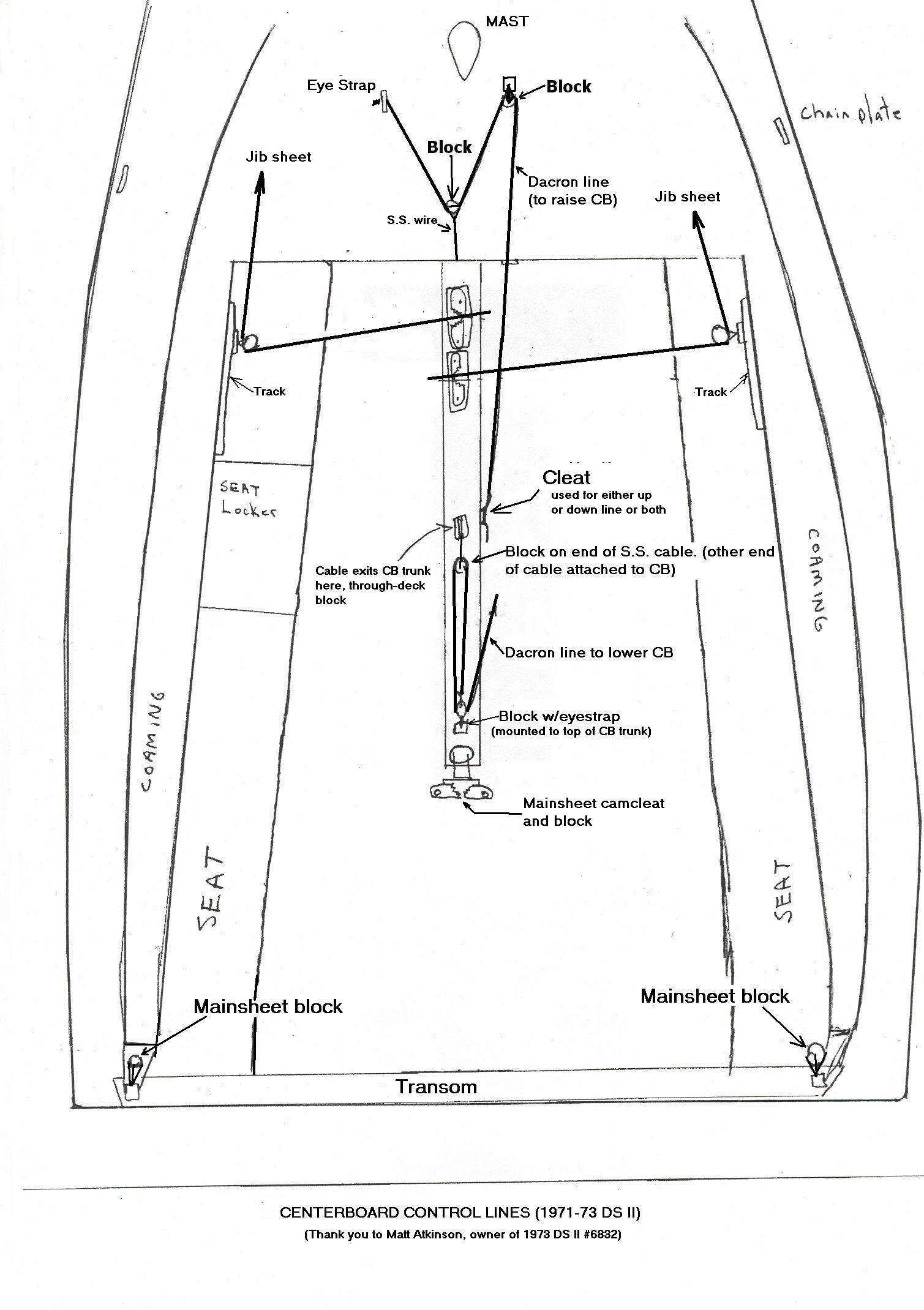

The block arrangement in the cockpit and cuddy matches this:

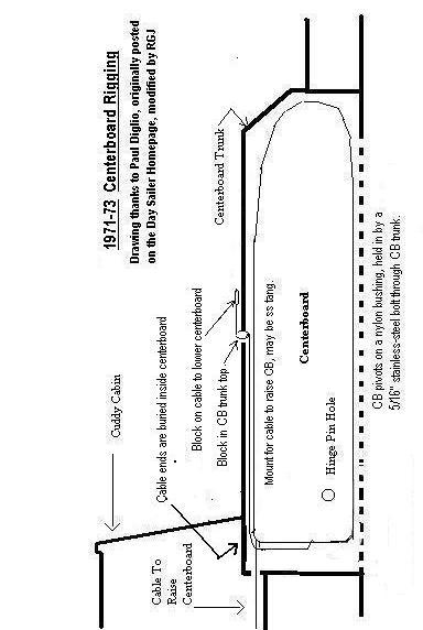

...which I believe *should* be cabled like this:
BUT... my CB has the ss cable(s?) attached at essentially the same spot:
wide:
...which works fine for the uphaul, but means the downhaul is only pulling the board a bit past 45*.

The square hole would be typical for receiving a DS1 centerboard handle. Looks like what you have might be a DS1 -or- DSII combination CB. How the CB would work with either of two pivot points isn't entirely clear, but perhaps it's possible.
Your second diagram shows that the downhaul should in fact pull back on the top of the CB until it's in the vertical position. If that matches your configuration, I can't see why you would get the board stuck at 45°. Unless, for some reason, not all of the cable is pulled out. If there's a crimp on the cable that limits how far it can be pulled out, that might be an explanation.
But, I'm not a DSII expert.

Thanks for the quick reply. From my exhaustive readings of back-posts here, you are certainly one of the people with the most to offer. I drew a little drawing to show how my setup (in the photos) differs from the diagram I posted:
As you can see, at it's tightest the cable is not pulling the board all the way down, but rather a bit past 45. If the cable were attached at the TOP of the board, especially towards the front of the TOP edge, it would pull the board back on the pivot to a vertical (or more) position. While there is a ferrule in my CB trunk, it is not causing the issue (I have a very good view since the thing is upside down).

UH and DH need to attach to different locations on the CB. Your hand-drawn diagram shows a config that can't work. The other diagram you had (the one that's rotated 90 degrees) seems to be the way things are supposed to work). Looks like you found the old threads relating to similar issues, so you should by now have enough to go by. (And yes, these boat builders happily "used up" parts from other models or even similar boats).

I think O'Day must have used DS I centerboards on the early DS II models. Two boats with identical boards built close to the same time makes me think this wasn't previous owners own ideas. The UH and DH line configuration used at some point after these boats (like my 1976 model) continued to be used on the DS II and DS III models. The later configuration the DH attaches at the lower front radius of the centerboard.
Ideiks, D&R Marine sells the cable attachments for the later configuration (UH & DH). http://www.drmarine.com/proddetail.asp?prod=DS106b and http://www.drmarine.com/proddetail.asp?prod=DS108
Also, you do not want to run any lines alongside the centerboard as it will cause the board to jam. The tangs pictured above are attached to the edges (upper for UH, front or lower radius for the DH).
