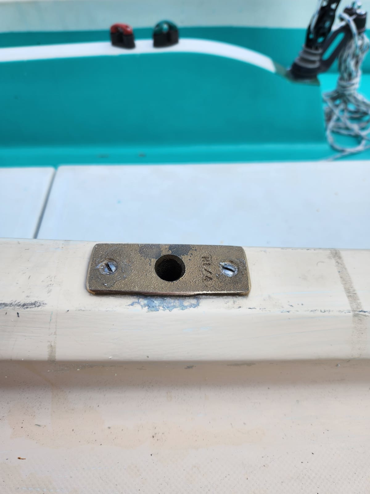

Any obvious reason why I couldn't just mount top mounted oarlock sockets on the top surface of the coaming?

Here's link to the picture of the oarlocks mentioned above
711
As you can see, this places the oarlocks as far outboard as possible, which would allow you to use somewhat longer oars that are likely more efficient.
My take, having rowed a friend's DSII across a marina once: the DS hull is not easily driven, making it awkward for both paddle and oars. I would rate either fine for limited distances.
Now the oars I was using were optimized for easy stowage, not optimized for best proportions and leverage. One of the problems is that correctly proportioned oars are longer than the bottom of the cockpit. It may be possible to carry them on deck, with their blades forward of the shrouds.

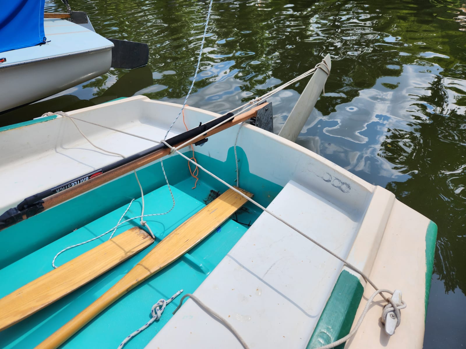

Interestingly, I used a couple of lengths of rope to fabricate a reasonable oarlock to find a pretty reasonable place to position a set of 8' oars. (I built a CLC N.E. dory a few years ago, own an 18' Swampscott and have logged many, many miles rowing)... I certainly wouldn't row it across the Chesapeake, but I'm confident I could pull it a mile or two.
I ended up using surface mounts sourced from Duckworks.
The objective here is to find a way back to the club when the wind is blowing 0-3, not try a novel new entrant in the Blackburn challenge.

Turns out the open space of the cockpit is just over 8' long, so 8' oars fit pretty well on floor of the cockpit... You slide the blade into that little drainage lip between the thwart, and the cockpit floor, they stay out of the way, mostly. I'm thinking if I mount a padeye in the middle of the thwart, I can lash them to the thwart.

So... mostly this was fact-finding, but I managed to row back in 2-5 kt breeze, maybe 400 yards, around an island.
The biggest issues:
1) You gotta pull the rudder or truss it out of the water. It isn't enough to just lash it to the centerline.
2) You gotta work the centerboard to trim the hull to adjust for weight displacement in trimming the hull. Just an inch or two of centerboard (from none) kept the boat from weathervaning into the wind. As the relative wind direction changed, you had to keep trimming the centerboard to keep from having to kill yourself correcting the boat.
If anyone's interested: I started off by just lashing the tiller, then worked my way up to just trussing it out of the water. In the future, I'll just pull the thing as part of the transition from sail to oar.

All in all, i was able to keep full control of the boat in a light breeze. I think I"m going to have to go longer on the oars, and switch oarlocks from horns, to closed circles.
