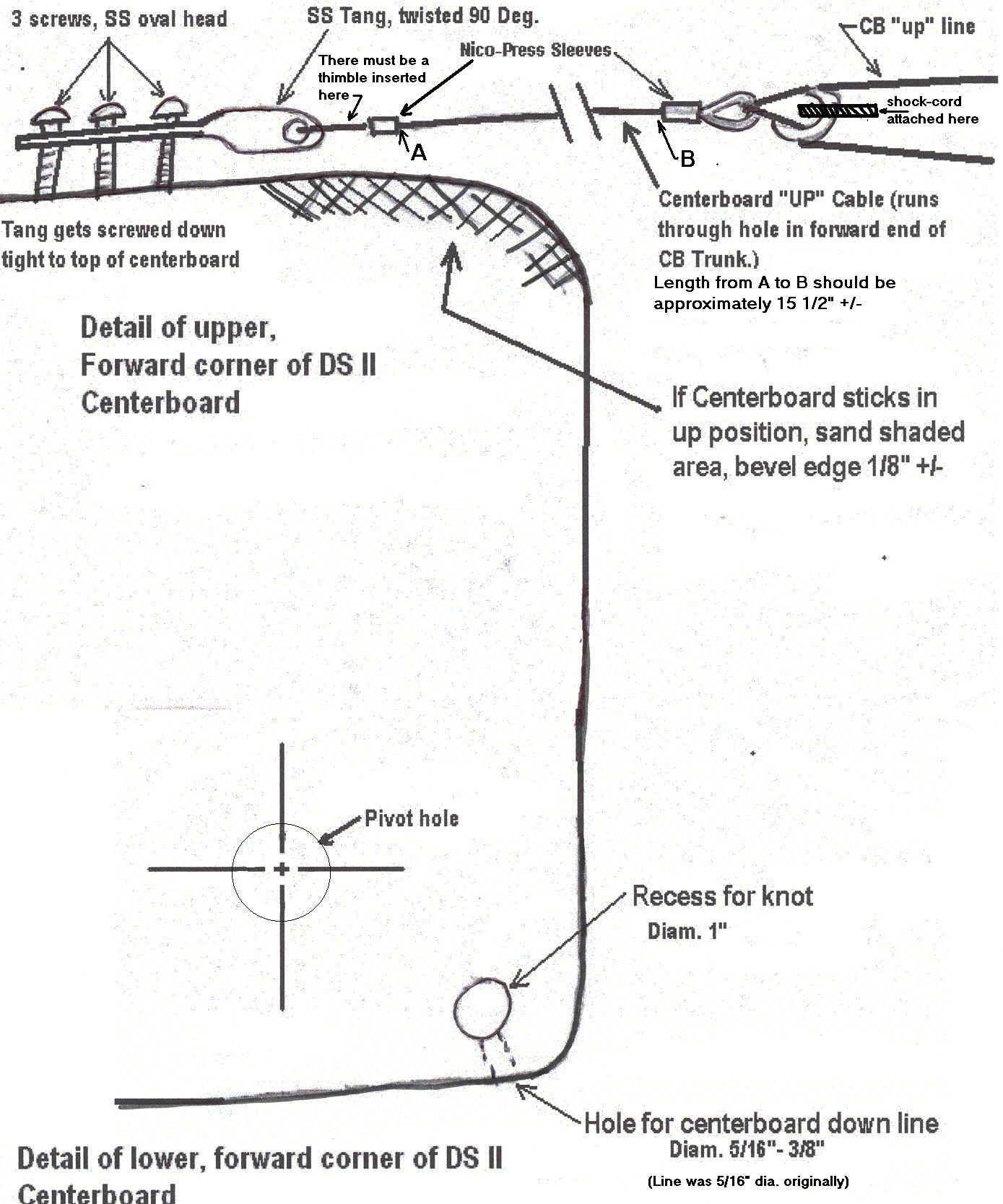

Postby SUNBIRD » Tue Mar 25, 2014 12:35 am
jeadstx wrote:I have thought about putting a 1/2" to 1" hole in the CB trunk just aft of the mid-section to be able to use a rod to push the CB down if jammed in the up position. Any time my board has jammed, it has been in the up position. I've never had a problem with the uphaul. Just something I was thinking about.
I did that! I used a typical threaded drainplug assembly to seal the hole while not in use (you will need to find a way to plug the hole in the actual CB trunk top as well to prevent water from squirting into the boat while sailing, filling the bilge, little by little! The only concern is being sure that you push on trailing edge of the CB and don't jam hte stick between CB and trunk side, (been there, done that!) also, be a bit gentle but persuasive while pushing....don't be tempted to use a hammer on that stick since the edge of the CB is not bullet-proof, I chipped the edge pretty good one time that my CB stuck. One other tip, my CB stuck in the up position at first due to the upper edge/corner of the CB being squared-off and the inside of the CB trunk is rounded, a little sanding/grinding to round over that edge helped a lot. See drawing below.
DS II_CB_top&bottom.jpg (255.95 KiB) Viewed 5768 times
