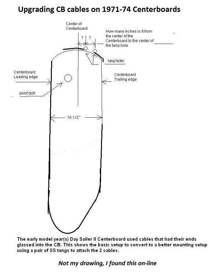

Your downhaul cable has ripped its way mostly around hte CB edge, it should be attached near the lower forward corner (when CB is raised.)
Check a search of the DSA web, I found a PDF file showing a modifcation of attaching the 2 cables with one metal bat (not 2 tangs), unfortunately, the forum won't allow posting a PDF.
See digram below...
This shows someones modifications, but gives the location of the cables much clearer?
OLD CB tangs.jpg (101.51 KiB) Viewed 21129 times

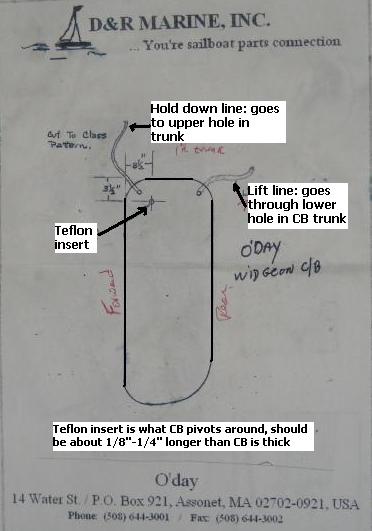

Diagram for the Widgeon, but if you substitute cables for the lines, the positions may be close.
WIDGEON CB Lines.jpg (28.03 KiB) Viewed 21129 times

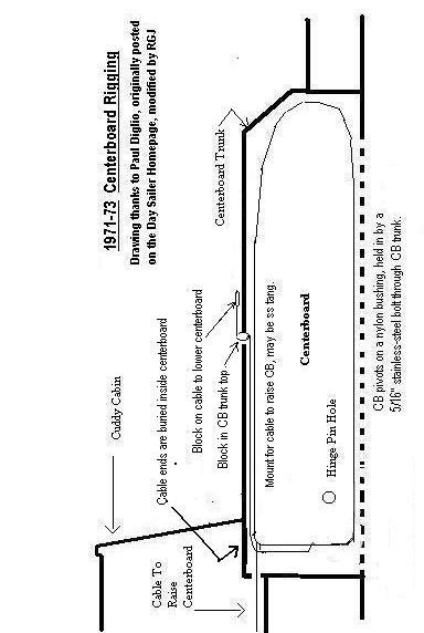

DS II_CB draw_71-73.jpg (31.76 KiB) Viewed 21129 times
