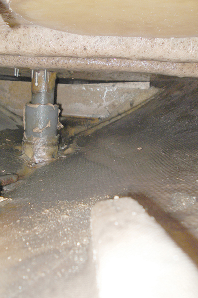

On the subject of DSII mast flotation, my 1980 has what sounds like the same stuff Talbot referred to. It's square in cross-section, and is a different foam than that used in pool noodles. I found it while replacing the base casting. It won't budge when I pull or push on it, which may be because it runs the length of the mast.
On the subject of bilge flotation, I just discovered a bilge flotation tank, different from the bow tank. It's mounted in the bilge forward of the mast. I've owned my boat for eight years, and I had no idea it was in there.
You can see the aft wall of it in this photo:
DSII compression post resized.jpg (189.65 KiB) Viewed 18993 times

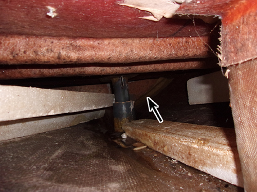

Here's a better photo, borrowed from jeadstx's gallery. At the right top, you can just see what looks like a piece of flotation foam. There's a similar photo in jdoorly's gallery, so we've got at least three DSIIs that have the tank.
DS2 compression post.jpg (241.67 KiB) Viewed 18993 times

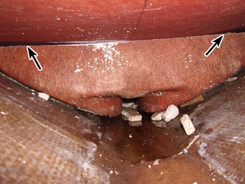

And here's what it looks like from the front. I got this photo by lowering a camera into the bow flotation tank through an eight-inch inspection port installed in the forward cuddy bulkhead. There are gaps at the top (arrows) and it doesn't look like it was ever attached to the cuddy floor.
So, I suppose I should put an inspection port in the cuddy floor above the tank and pull out the flotation foam to see if it's still dry after all these years.
