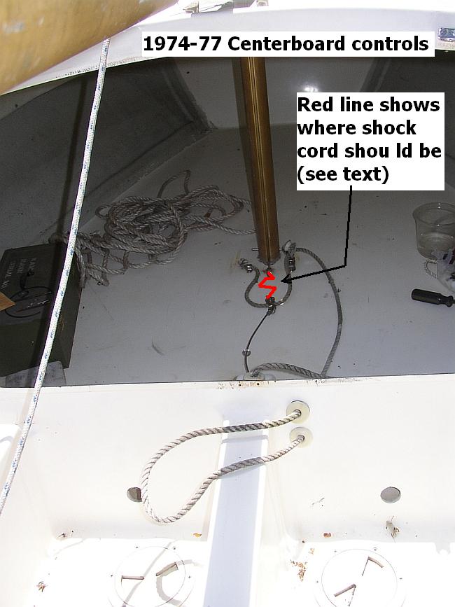

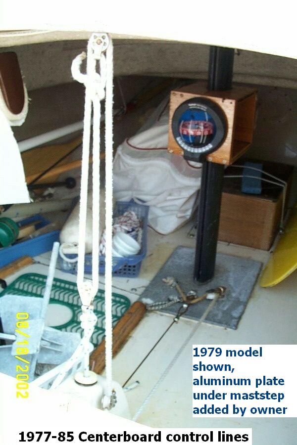

1977-1985 setup (1979 model shown)
1974-76 setup (actually includes some 1977 models)
1975_CB controls.jpg (72.23 KiB) Viewed 8562 times

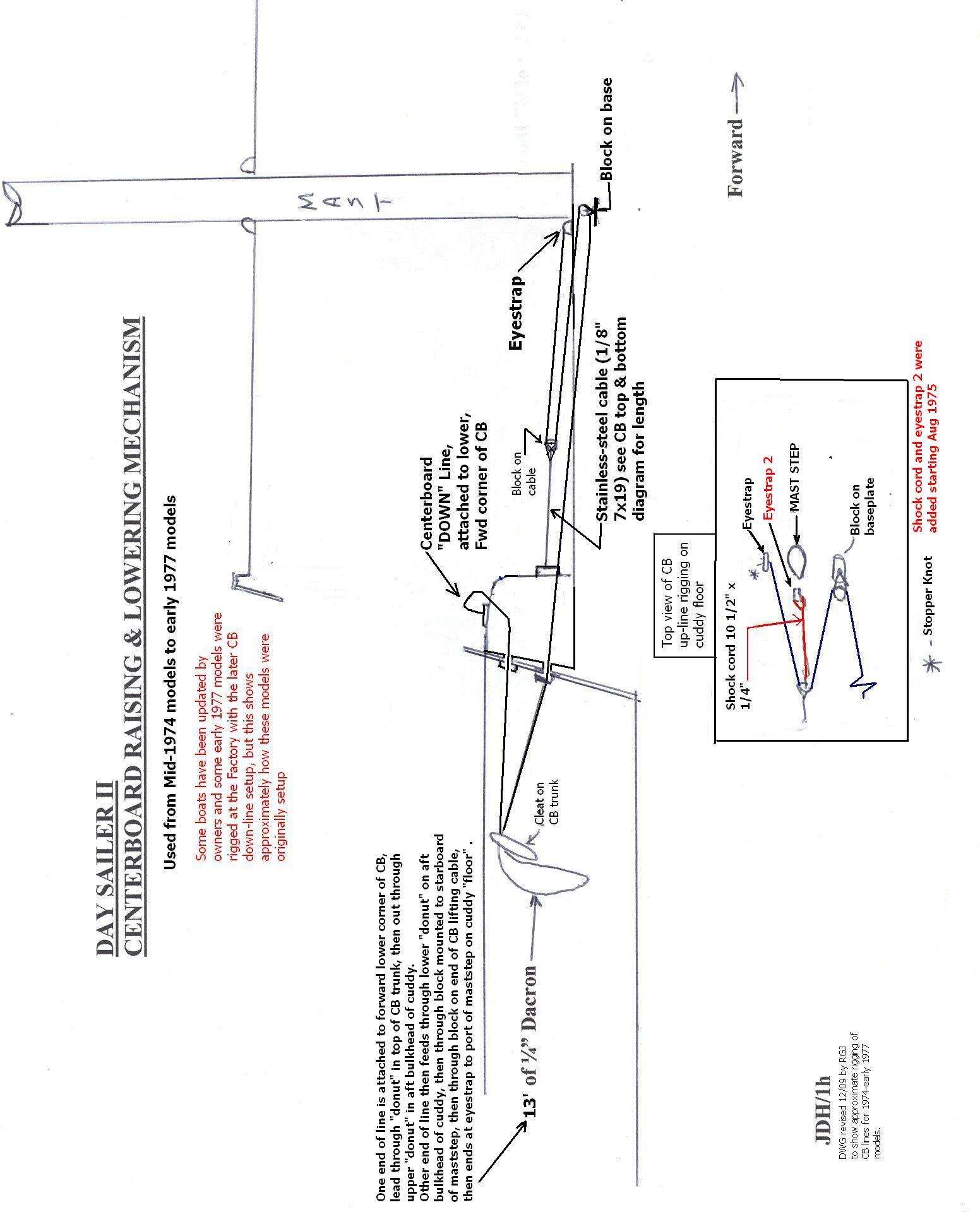

1977-85 side-view drawing
DS-II_cb dia.jpg (188.63 KiB) Viewed 8562 times

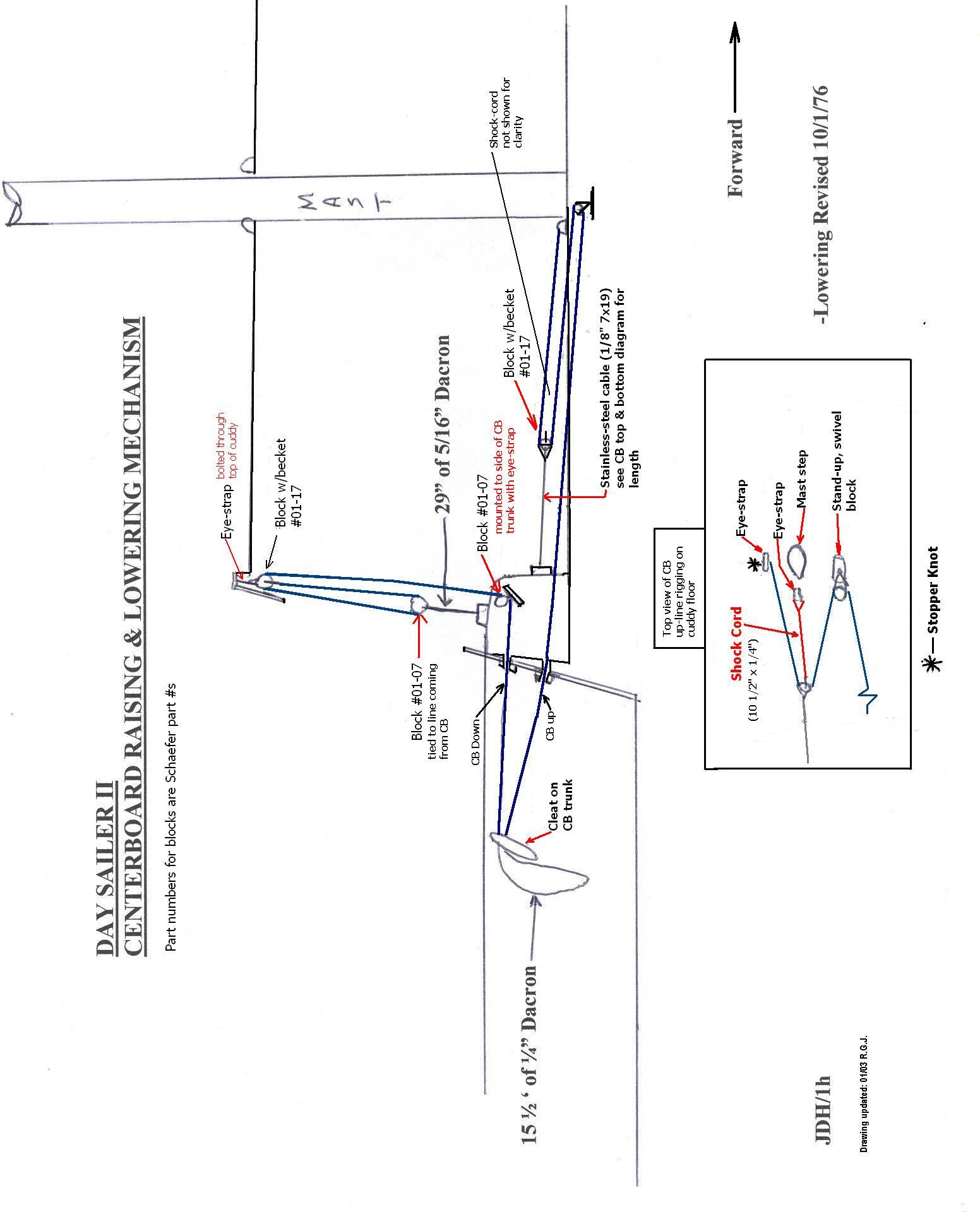

1974-77 side-view drawing
DS-II_cb1974-77 dia.jpg (231.48 KiB) Viewed 8562 times

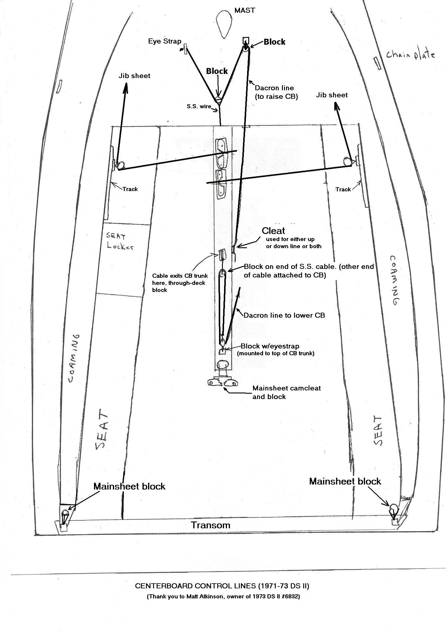

1971-73 setup
DS II_CB draw_71-73.jpg (31.76 KiB) Viewed 8562 times
Here are the rigging diagrams that I include in my expanded DS II Owners Manual.
Rod Johnson, "SUNBIRD"
