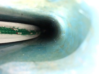

Hey everyone, sorry I didn't mean to leave this thread hanging but a lot's happened since I started this project including a career change which has kept me busy. Have meant to finish this for a while.
Long story short, the channel seems to have fixed my CB jamming problem. After putting everything back where it belonged, I was able to consistently raise and lower the CB over a dozen times with no issues whatsoever. Here in this photo you can see the CB back in the trunk w/ the downhaul line sitting comfortably in it's groove. A huge improvement from before.
Centerboard re-installed with the downhaul neatly tucked in it's new groove
CB 1.jpg (13.7 KiB) Viewed 12549 times
I haven't taken her out on the water yet. That will be the real test but I'm optimistic that I've solved the problem.

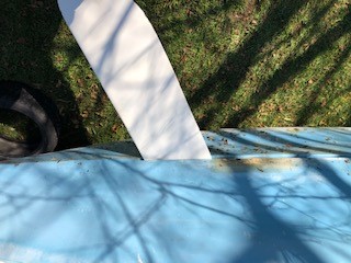

As a sidenote, it's fascinating to see the CB mechanism in action with the boat out of the water. Couple of observations:
1. My CB won't fully retract unless I give the uphaul a swift tug and keep tension on the uphaul. The extra momentum helps get the board fully up. Otherwise there's too much "stretch" in the system to fully raise the CB. I've gone to marking the uphaul with a piece of tape so I know when the CB is fully up.
2. Likewise at full extension the CB sits well past vertical. This can be seen in the below photo where it looks to be at least 20 degrees forward of vertical.
Fully extended CB is well past vertical
CB 2.jpg (44.39 KiB) Viewed 12549 times

Re: DSII CB Downhaul repair
Postby GreenLake » Fri Jun 12, 2020 2:27 am
I don't know whether there's a situation where you'd ever want the CB forward, so you might want to mark your downhaul...
Postby Champlaner » Mon Jun 15, 2020 12:14 pm
Mine is vertical with about 2" of downhaul "capacity" left. I read somewhere that the forward position might work well for heading up light air, but I had to deep-google for that and I'm not really that curious. Though I might have to figure out whether to put tension on the uphaul as well to keep it vertical (?)
'77 DSII #8420
Champlaner
Posts: 28
Postby GreenLake » Mon Jun 15, 2020 2:04 pm
The forward position would put the CLP forward, which would tend to increase the weather helm (or compensate for the CE having moved forward). I can't quite see how this works in light air, so I'll note that as a question in the "Seamanship and boat handling" section, where we might get input from others.

My centerboard jammed yesterday in the up position and I broke the down haul trying to swing it down. This is super helpful! Question for anyone who might know…how does the end of the downhaul line attach to the centerboard edge? There is a clear pic in this post that makes it look like the rope simply disappears into a hole in the edge of the centerboard, but how is it attached? Thank you!
wynnron1
Posts: 1
Joined: Mon Sep 16, 2024 2:25 pm
Postby RaleighRancher » Thu May 15, 2025 9:45 am
What you don't see in that picture is a second hole that has been epoxied over. The hole in the leading edge intersects a second ~1" hole through the side. The downhaul line goes into the smaller hole in the upper leading edge and is tied off in the larger transverse hole, then embedded in epoxy.
