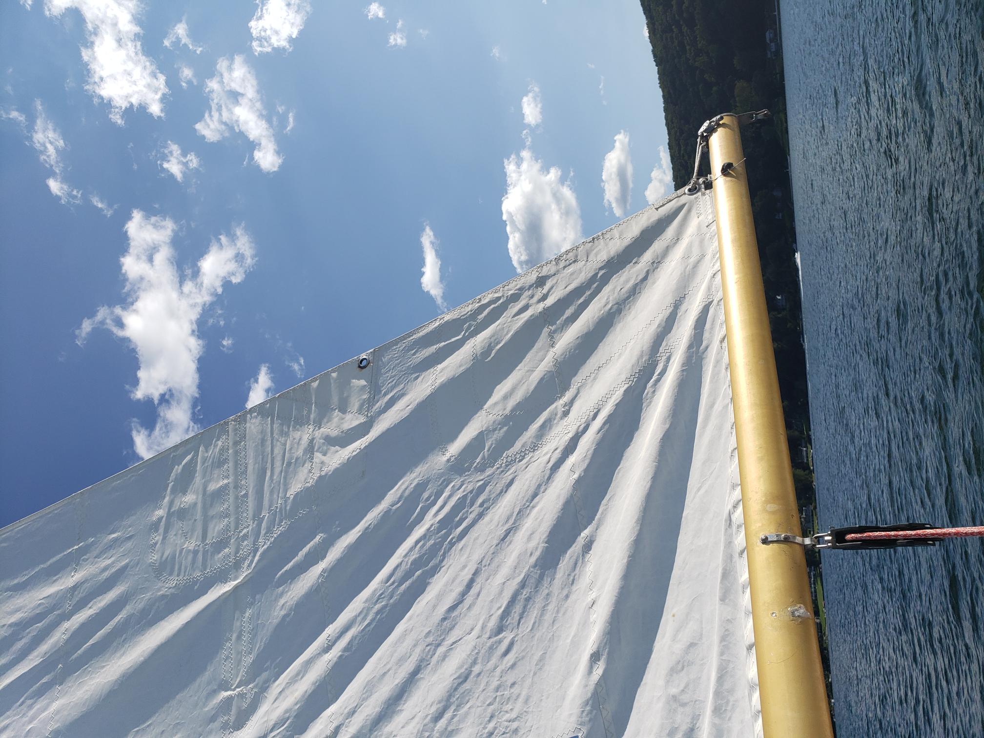

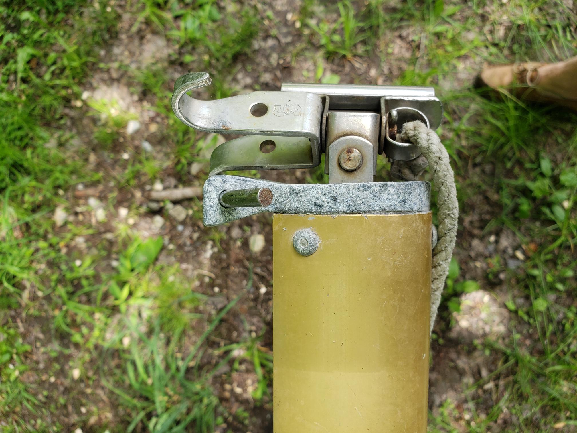

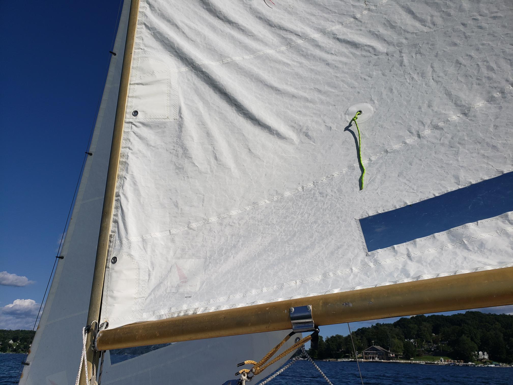

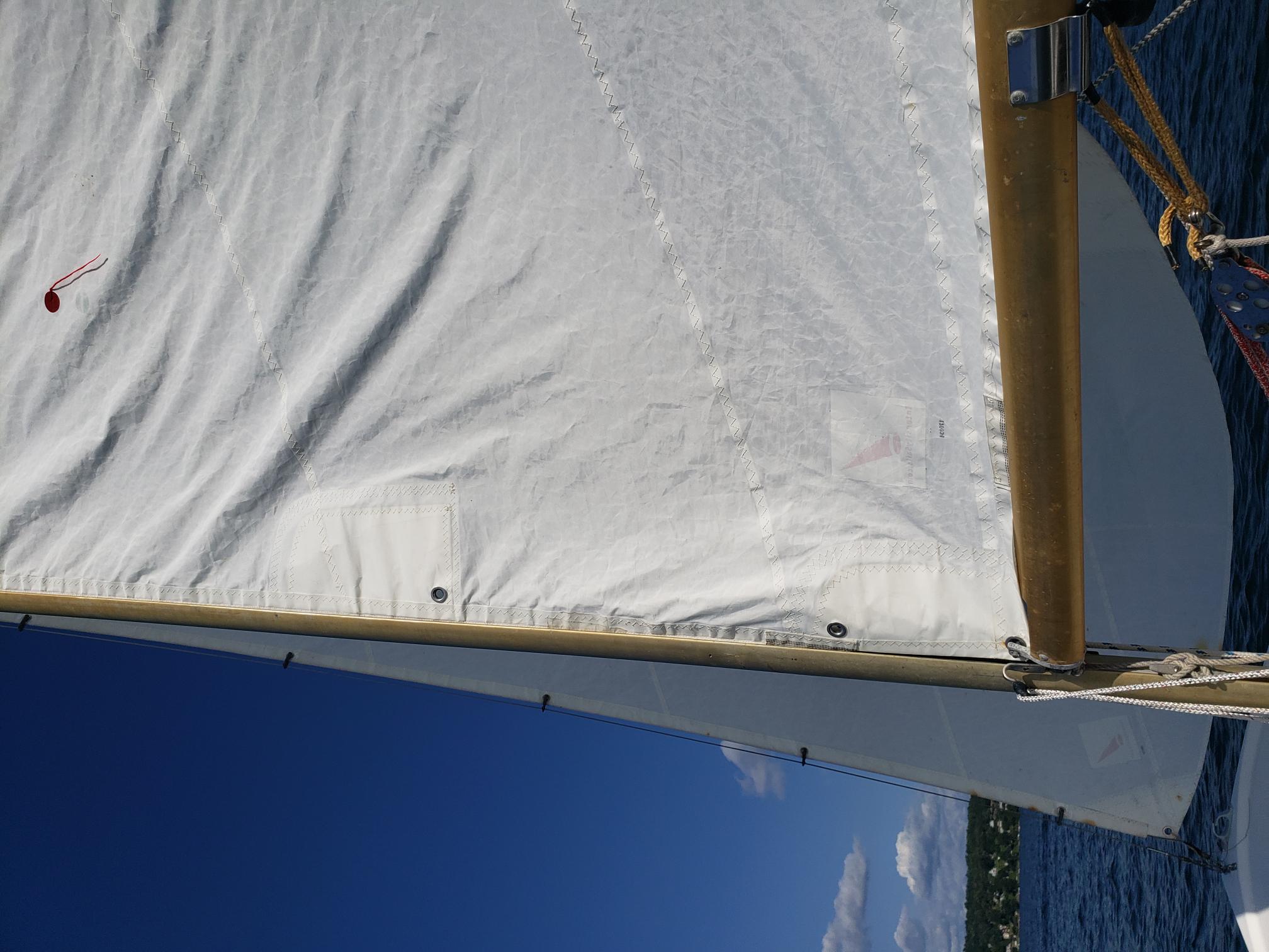

Postby Quiggers73 » Wed Aug 14, 2024 11:13 pm
Pics of sail and reefing hook.
Does the hook go through one of the eyes on the sail ? Or a tie.

Postby GreenLake » Thu Aug 15, 2024 11:17 pm
In your photos I see that you have center boom sheeting with a fiddle block. You seem to have a vang, can't quite see what the purchase ration is. I see your reef hook.
It's nice, with the two horns you can put two reefs in. Useful if you really sail in an area where stronger winds are common and/or unavoidable (as in, might hit you far from home/safe spot).
I see only one reef point in the sail. The other, lower one in front is for a Cunningham (I'll let you google that one). Helps control sail shape when not reefed. The Cunningham would be a line going through the lower cringle, and the upper one is your first reef point and gets hooked when you reef (no line, but you need a line for the one in back - we all described that here in detail, happy hunting).
I also see a boom donwhaul at the gooseneck, and an outhaul at the end of the boom, plus an eye strap that seems destined for a reef line.
