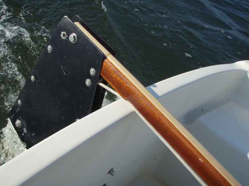

I purchased my 1983 DSII last month. Previous owner (PO) had made a beautiful new tiller — some special dark wood that I think starts with A laminated around white pine.
P7050079_tiller-rudder connection_reduced.jpg (31.58 KiB) Viewed 14859 times
Sadly, this tiller is unsatisfactory because it droops. Is there something I can do to raise it up to at least be level? Also I notice that the rear hole in the rudder head is now unused. Is that part of the problem? FYI, PO is an accomplished woodworker but a newbie sailor. : )

There's nothing wrong with shimming the tiller a bit. Many rudder heads have an adjustable (or carefully positioned) stop that limits the tiller position. This one seems to rely on the fixed bolt which many have been positioned too low. Mounting it in the rear hole instead, might also fix things, simple enough to try. If that doesn't fix it, just glue something underneath the tiller where it rests on the bolt on the forward end. That should do it. (Just as long as you don't raise the tiller to where it is no longer held by the two plates. I don't think that will be an issue, because I suspect just a little amount of shim will make the necessary difference.

Thank you, Green Lake. I'm planning to try out your suggestions this weekend (on the trailer). First, moving to the rear hole; if necessary, adding a shim to the tiller where it rests on the forward bolt.
