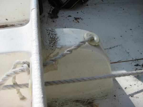

Postby gabond » Sat Mar 09, 2013 11:09 am
Sun was out today, so took off the cover to get a good pic. Attached is the current situation with the cb completely uphauled and cleated. The two intact strands of the downhaul are visible to the right of the cuddy face, with the 3-ply to the left and the broken strand hanging loose. The problem is that I can't pull the downhaul through the entry hole on the cb trunk because the broken strand on the inside jams. That face of that curved trunk inside the cuddy was where I considered placing a 4" port.
But doesn't the cb drop of its own if not cleated? Thought I saw that somewhere.

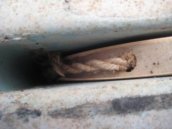

Aha! Now that the snow is gone and the ground not underwater, I was able to crawl under the boat. I now see that that one strand has broken at the insertion point into the cb, and just make out the end of the broken piece at the left side. This means that there is a free floating remnant between the bottom of the hull here and the exit hole on the cb trunk--unless actually two strands are broken, one at the exit hole and another underneath.
Roger says: "If the downhaul is parted where it inserts into the centerboard, this is good news in that you may not have to remove the centerboard to do this repair." I do not intend to repair this, thinnking what is easy for him may be a PITA for me, but have the following minimal procedure in mind:
  • try to remove the broken off remnant with needle-nose pliers or something similar (edit: nope, it is laid rope and one strand does precisely not move against the others)
  • cut back the broken strand on the outside of the cuddy wall and crimp or glue it to the two remaining strands
  • make sure that the result allows the cb to be lowered with the two remaining strands
  • hand the new owner Roger's document and point to the relevant page
Any thoughts about that?
