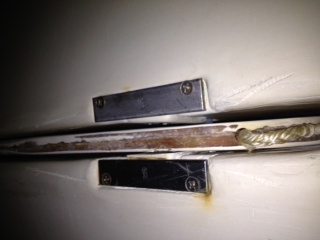

We discovered that the center board downhaul line is frayed, and my friend suggested I replace it before the next sail. What are the specs for that line?
Also, with the uphaul line taught, the center board does not retract fully up into the hull. Is that normal? It does retract up enough to get the boat off and on the trailer.

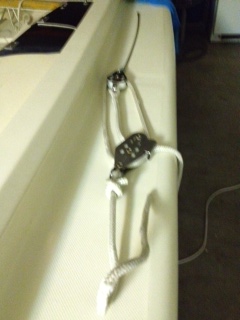

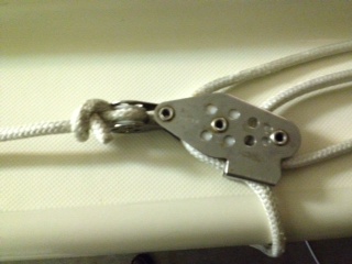

The boom vang rigging is not typical according to my friend. It looks like the one D & R Marine has, but the mast has a fixed bail rather than an eye fitting. There is a block riveted to the fiddle block (with V jam cleat) in the boom vang where it should connect to the mast. We used a short rope between the block and the bail, but it was rather kludgy. The other end of the boom vang attaches to the boom with a cable through a keyed slot on a bracket on the bottom of the boom. My friend said I might need to replace the fiddle block with a better one with a clam cleat.

Thanks for your comments. I included three photos of the boom vang in this post. Figure 1 shows me holding it next the the bail on the mast where it was tied to. Figure 2 is a photo of the entire boom vang. The end with the wire attaches to the boom, and the end with the rope attaches to the mast, Figure 3 is a photo of the fiddle block with V jam.

As such, there's no problem with using a fixed bail on the back side of the mast. It's a common alternative to having an eye strap on the forward side. Cam cleats might work better than the V cleat.

For now I quess I'll just tie the exsiting line from the block on the fiddle block to the bail on the mast.
I did see a few interesting photos in Roger Conrad's book. (It came with the boat when I bought it.) The photos show a lower extender between the boom vang fiddle block and the bail, The extender is a stainless steel cable with tube covering, abd snap shackles. An extender would at least make the fiddle block more accessable for adjustment from the cockpit.
Keith

You could use a longer piece of rope?
A lot of the places where traditionally one would have used steel cable can nowadays be fitted with Amsteel.

Attached is a picture of my boom vang attachment. My vang is original to the boat. It is attached on the mast end by a line running thru the loop riveted to the front of the mast. I add some cable protector to the cable to where it attacheds to the boom
Your centerboard should be easier to drop than mine since you have the plates rather than a centerboard bolt like I do on my 76 DS2. I'm sure someone with the plates will comment on centerboard removal with the plate setup you have. The centerboard should retract all the way. You may have an obstruction in the CB trunk (something like a wasp nest perhaps) that is preventing it from retracting all the way. If you pull the board to replace the line, inspect the inside of the CB trunk.
