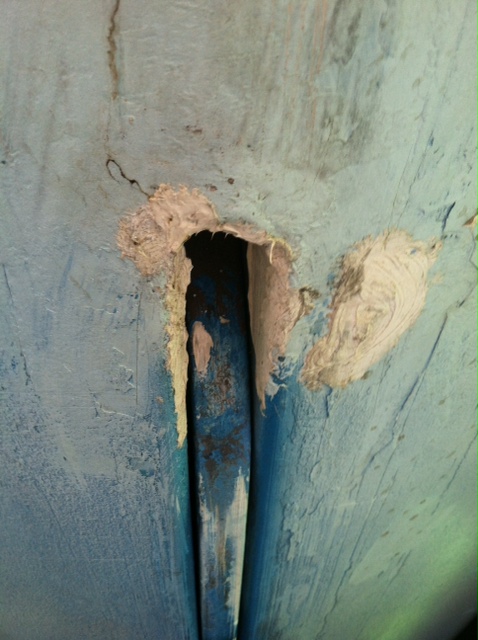

I've got a '73 DS II taking on water into the hull. I have found a hairline crack 1/2' long (at the aft edge on the center of the hull where the trunk begins to turn up and into the hull). There is some kind of goop already on there, from what looks like a previous "event". The white goop seems to be holding, but it is the black "?" looking crack angled towards 10 o'clock that is letting in/out water. When I dump water into the hull, it lets out water, a drop at a time. The boat is new to us, as off last year, and it always took on a little water inside, but nothing major.. This year, after our first 4 hour sail there was a significant amount... taking minutes to drain out of the rear port. Seems like I have more of a leak somewhere than this hairline crack...?.. There was not enough water on the deck that could have seeped through the deck inspection ports.

A local shop recommended I dry it out and cover the crack with 3M 550 ( Polyurethane Adhesive Sealant). Do you all agree? I could
He also recommended (incase the gaskets are leaking on the CB bolt) I use the same stuff to re-lube the inside of the bolt that holds the centerboard to the boat... by loosening the nut, pulling the gaskets away from the hull and squirting the sealant around the bolt on the inside of the gasket and then replacing.
Any thoughts? I am new to boat repair, so appreciate any feedback.
I'm also debating puting in an inspection port just inside the cuddly to get a better look and access. Good or bad idea. Where is the best spot? Seems like a central location between CB and Mast foot, so I can access both if need be.... 6" or 7" any structural concerns?
Vince

I personally would not use sealant on a hull crack. If this were my boat I would dig out the crack and, if the damage wasn't structural, would use epoxy and glass to fill it; or, alternatively, I'd use 3M high strength marine filler (the high strength filler is polyester resin reinforced with chopped glass fibers).
If moving the CB from side to side with some force does open the crack, or makes it flex in other ways, the damage is structural. In that case, the way to fix it would be to grind a very shallow V along the crack and rebuild the laminate in there with epoxy and fiberglass. (It sounds more scary than it is, and nothing you can't do yourself - you can check older posts here for details and then come back with questions).
And, yes, immersed for four hours, even a small opening can add up to a lot of water.
I have a DS1 where the CB trunk (and gasket) is exposed, even a small drip there also adds up, so be sure to check for leaks there. Hopefully someone with a DSII will come by here and be able to give you more detailed suggestion on how to check for and fix those kinds of leaks.

+1 for what Green Lake said. Fiberglas and resin are the fix that you want to use on the cracks, and it's not that bad.

Thanks for the insight! I really appreciate having a place to go, especially starting out where I am with boat maintenance and repairs. I've got things drying out and will hopefully do the repairs tomorrow... does not seem structural!
I'll keep the UH in mind, but first off plan to seal the crack and "repack" the gasket (with sealant) on the bolt connecting the CB to the trunk....
