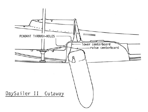

centerboard diagram
Hi,
I have read the following fix for the centerboard uphaul/downhaul leak with the wire cutting thru the centerboard trunk.
Used a 3/4" metal pipe that I cut lengthwise into with a hacksaw to make a "hole threader". I then went to the hardware and bought a 1" long ABS plastic threated nipple with a nut fitting on the other end. (about $2) and capped that with a 1/2" end cap with a 1/8" inch hole in the end for the wire. I think it is used to couple a threaded pipe to a slip fit pipe. It stops all water from coming in to the cuddy. A simple threaded nipple would likely do the job also. About an inch long. The gap between the two fg hulls is only about 3/8" at the most, the thickness of each hull is 1/4" at most, so a total nipple length of 1" is really all you need. I liked the nut idea because it allow me to use a wrench to install it. Too simple!
I would like to do this repair but have a few questions about the above procedure. If anyone has done this repair I would appreciate a reply.
Question 1. How to remove the plastic o-ring that if on the forward end of the centerboard trunk that has the cable running thru it? (preferably not breaking it)
Question 2. What do you do with the 3/4 metal pipe hole threader listed as the first part of the fix? What am I trying to thread - the part where the plastic o-ring is currently inserted or the centerboard trunk where the fiberglass hull encases the centerboard?
Question 3. Once "threaded" do I leave the metal pipe in place or remove it to insert the 1" long abs plastic with a nut on the other end?

Would love to help Bob, but I'm not sure I'm really understanding the fix described. Photos would help a lot!
I will tell you that the plastic donut can be easily pried off, and it doesn't matter if you break it because it is not used for any of the methods for fixing this issue.
Bottom line is that what you are trying to do is isolate the bilge from any water that gets "pumped" into the UH channel. Keeping said water from squirting into the cuddy is a whole other issue ... ;-P

I used the threaded nipple to thread both walls of glass... I'm not sure if the other people who have done this also thread that far, or if they're just threading the "inboard" layer of fiberglass and letting the nipple press securely against the inside. I realized I had started to thread the second layer, and figured it was better to just keep going. When I inserted the plastic nipple, I smeared a little silicone on it for good measure, then used channel locks to twist it in. It was pretty snug. My boat was upside down when I was doing this, so it was easy to look up into the trunk and see that it had emerged entirely into the trunk. This made a pretty tight seal from the water side of the centerboard trunk through to the cuddy.
However deep you decide to thread, you REMOVE the steel nipple and then thread the plastic one in its place. You're essentially using the steel nipple to tap threads for the plastic one to thread into. It's a tool more than a part of the repair.
