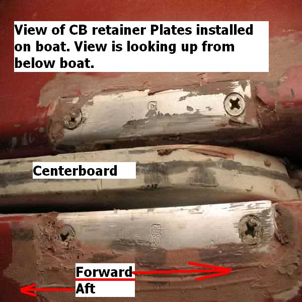

A few months ago, I purchased Roger Conrad's PDF book on all things DS II related. He goes into great detail on how to inspect and if necessary, remove the keel to swap out the ropes which control the up/down movement. (By the way, Roger Conrad's PDF download book is excellent and well worth purchasing a copy. You will learn a great deal about the inner workings of your DS II.)
I recently carefully "careened" my DS II in my driveway in order to remove 33 years of oxidation and check out the keel operation at the same time. I have attached a photo of what I found upon removing the keel from the bottom side of the boat.
Instead of finding the keel held in place by a stainless steel pivot bolt, there was no bolt to be found! In my boat, the keel pivots on a 4" round nylon core and held in place by two trapezoid shaped fiberglass blocks.. These blocks are held in place by the two stainless straps and bolted to the bottom of the hull.
At first I thought a former boat owner installed his own "midnight engineering" only to find that the two cores which support the weight of the keel are formed into the fiberglass bilge itself... so it had to be factory-built this way. I figured, "if it ain't broke, don't fix it". And I reinstalled it as it was.
I hope this attached photo is useful to someone else in understanding your DS II.
Any comments?

Earlier DS II boats used a centerboard bolt (like my 1976 model), the later ones used the setup you have. Your setup is easier to work on than mine, since I have to reach in thru 4" inspection ports to get at the bolt. Unlike most boats, I also have the added pleasure of dealing with some really hard goop that was put over the bolts and will need to be ground off before I can remove the bolt.

FYI, there are more drawings and photos illustrating the chronology of DS II centerboard systems posted by Rod Johnson in 2005 on this thread.
Picture of DSII centerboard downhaul
viewtopic.php?f=2&t=4378&start=15

Rakozy wrote:In my boat, the keel [centerboard] pivots on a 4" round nylon core and held in place by two trapezoid shaped fiberglass blocks.. These blocks are held in place by the two stainless straps and bolted to the bottom of the hull. [...]
SUNBIRD wrote:Re: Picture of DSII centerboard downhaul
Postby SUNBIRD » Mon Mar 24, 2014 7:31 pm
https://forum.daysailer.org/forum/download/file.php?id=243
Followup question.
Assuming the stainless plates holding my CB are held in place by screws as shown in Sunbird's photo (and that the threads are intact), do I need to do anything to the screws or holes when I put the CB back? (to ensure a good seal)
1983 DSII 12250
Stonington CT
IslandFarmer
Posts: 74
Re: Keel Inspection/Removal
Postby talbot » Wed Jun 23, 2021 1:14 pm
I would use a below-waterline, nonadhesive caulk. 3M 4200 probably.
Do NOT use 3M 5200, which will make it difficult to work on the CB in the future.

Having now removed the centerboard, whose setup is identical to Rakozy's 2015 photo, I found that the stainless plates were bedded with a white compound that is still soft and pretty sticky too. The bolts (not screws) appear not to have anything on them ... save perhaps a little of whatever was used to bed the plates. I hadn't actually thought of putting anything under the plates. . . . (Regarding exposure to fuel . . . although I don't have a motor on my boat, it is moored for 2–3 months in an area highly trafficked by motor boats.)
It was great having Rakozy's photo. Since the CB set up is functional, I decided to leave the centerboard resting on the inverted hull with the cable attached while I put 5–6 inches of antifouling paint in the CB trunk and the leading edge of the very top of the CB. Then replace the CB and paint the leading edge while vertical. Lastly paint the rest of the bottom, but that's another thread I'll read up on. . . .
