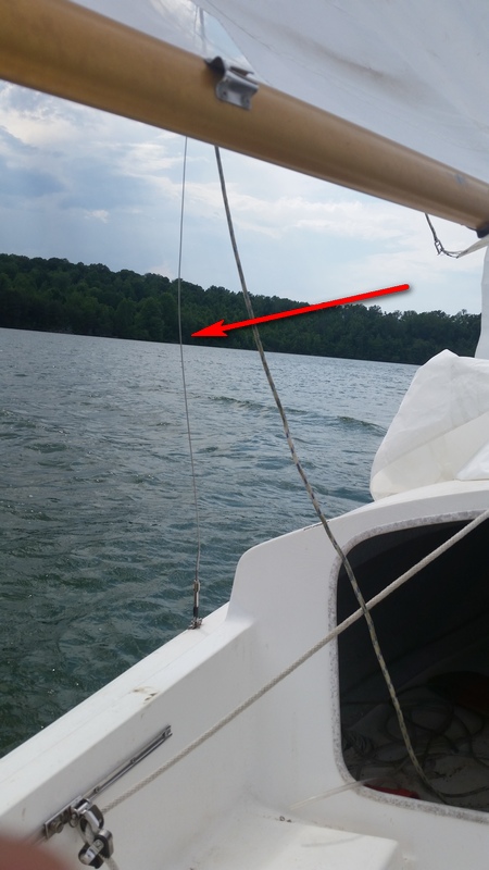

Postby jsbowman6 » Wed Jun 01, 2016 6:35 pm
I just got back in from sailing and noted the leeward side stay (either side) becomes very loose. Is that normal? If not how should a 1975 Oday daysailer be setup?

Postby Shagbark » Wed Jun 01, 2016 9:59 pm
Loose? Yes. Very loose? I would say no. But then again, these are very relative terms. I believe I have my rig tensioned enough because I struggle to attach the forestay when rigging. Not very scientific, but if it's a pain in my a*# to attach the forestay, I must be closer to getting it right than getting it wrong.

Postby TIM WEBB » Thu Jun 02, 2016 9:42 am
Most tuning guides suggest "slight" slack in the leeward stay in moderate winds. Pretty subjective, but a good place to start.

Postby DigitalMechanic » Thu Jun 02, 2016 3:16 pm
When I bought upgraded 1/8th stays from Rudy at D&R, he told me the side stays should make a twang when plucked, and the leeward one should go a little sloppy when underway. You probably can do that with out a Loos Guage, but if you are a numbers guy here is what I have noticed...
My side stays have around 180lbs tension when the mast first goes up, but after it sits for an hour or 2 it goes down to around 150-160lbs. The forestay will be less at roughly 60-65% what the side stays are. For example if the sidestays are at 200lbs tension, the forestay is probably going to be between at 110-130lbs of tension. This was about where I was at after following a tuning guide about mast rake and bend, etc. I did not quite like 200lbs tension on the sidestays, not so much because of how it sailed, I was just nervous about the toughness of the boat. Anyway, a buddy of mine that races said he would tighten the rig up considerably, roughly double what it is now. I asked him if that would either break the gunwales off the boat with a good gust, or put the mast through the bottom of it coming off the right wave, lol. He seems to think the boat would handle the tension fine, but I am sticking with my gut and keeping it where it is at. I am not that experienced of a sailor, but I think it sails fine. Maybe I will appreciate more tension on the rig later? Anyway, I think there is probably a bit of room to adjust the rig tension to ones preference. It does not sound like a one size fits all kind of thing.

Postby GreenLake » Fri Jun 03, 2016 1:40 am
Looks a little loose in the picture.
Loos gauge and "twang" method delivered the same results on my boat.
I have never bothered to check mine for creep - but something to look at after a longer outing

Postby itguy1010 » Fri Jun 03, 2016 8:37 am
I've looked at your photo about a dozen times and to me (again, no expert) for your point of sail which I'm guessing is close hauled in a light wind, it seems kind of loose. But, all the previous comments are how I do it.
The thing I've heard to NOT do is tighten the side stays while underway. I trailer sail so my setup is done on the ramp before launching and I get everything about "twang" tight and I've never had a worry.

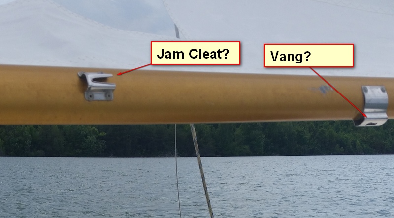

Postby jsbowman6 » Fri Jun 03, 2016 10:52 am
All,
I was sailing in some fairly fresh wind previous to a thunderstorm. Not sure how fast the wind was gusting, but it would heel the boat to a point, I wasn't comfortable, so I dropped the jib to reduce power some. I haven't sailed in 13 years or more and that was last done on an O'Day 22 which I am very familiar with and trust. This little fellow, I'm not certain at what point of the heel, I'll go overboard. One day I may put on a mae west life jacket and push it to the limit. Anyway that stay was just floppy. The stays are also loose on the ramp. I noted the spreaders had pulled a rivet loose on each and I'm certain that's not helping matters. I have new spreaders and rivets, but am waiting on Amazon to ship new spreader boots. Then I intend to go to adjusting. I like the idea of some tension while unloaded.
Eric,
Huuum, so the fitting on the boom is a jam cleat? I have 2 other cleats near the out haul and use them since the mains out haul line was a bit short. Is the other boom fitting for the vang? Thanks.
haul and vang.jpg (125.02 KiB) Viewed 21124 times
jsbowman6
Posts: 52
Re: Side Stay Adjustments
Postby klb67 » Fri Jun 03, 2016 2:25 pm
I'll go ahead and reply. You have those cleats correct. The one on the side of the boom is the factory main outhaul cleat. It sounds like someone added additional hardware at the end of the boom that you are using. I wonder if that added hardware might be for a reef system. You also labeled the factory boom vang cleat. A swagged ball on a wire goes in the slot.
