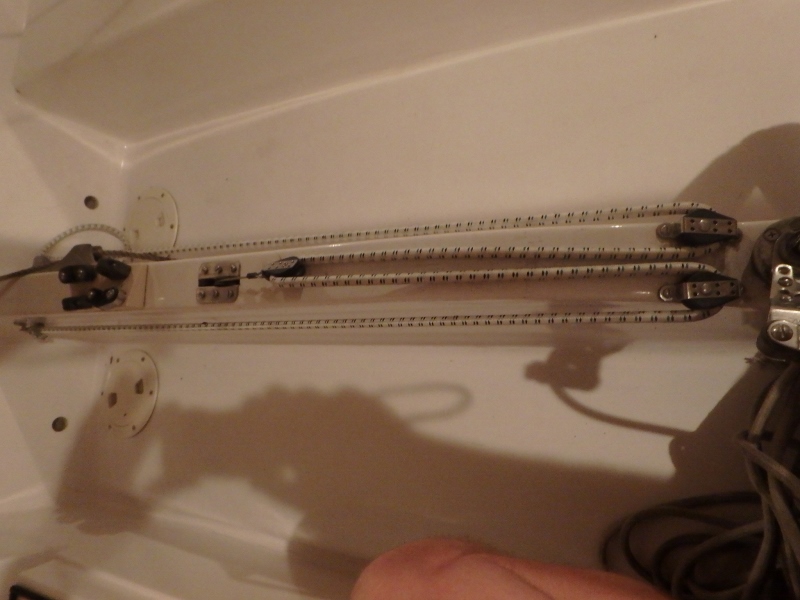

Postby windwalker » Tue Jun 07, 2016 9:29 pm
DH set up
P6070009 (600x800).jpg (194.4 KiB) Viewed 21090 times

Postby TIM WEBB » Tue Jun 07, 2016 10:13 pm
Wow, is that DH setup all bungee cord? Can't imagine how that even works? Definitely the earlier DH setup tho. Your UH looks pretty normal, with the exception of the bungee on the center block. Not really needed if you keep tension on both UH and DH when raising/lowering CB.

Yes the DH is all bungee. So that's not good? Here's a picture I got of the CB in action at full heel, seems like its down all the way?

Having shock cord on the CB downhaul isn't necessarily a problem. The reason to do it is to allow the CB to rise up in the trunk if it hits something. The previous owner obviously put some thought into the system. It is unusual to have the whole system be elastic. But I would not worry about it until you get the board unstuck. Then hook it all back up to the cable and try it out.

Not saying the all-bungy DH arrangement is a bad thing, just wondering how/how well it works? Just fine apparently! ;-P
