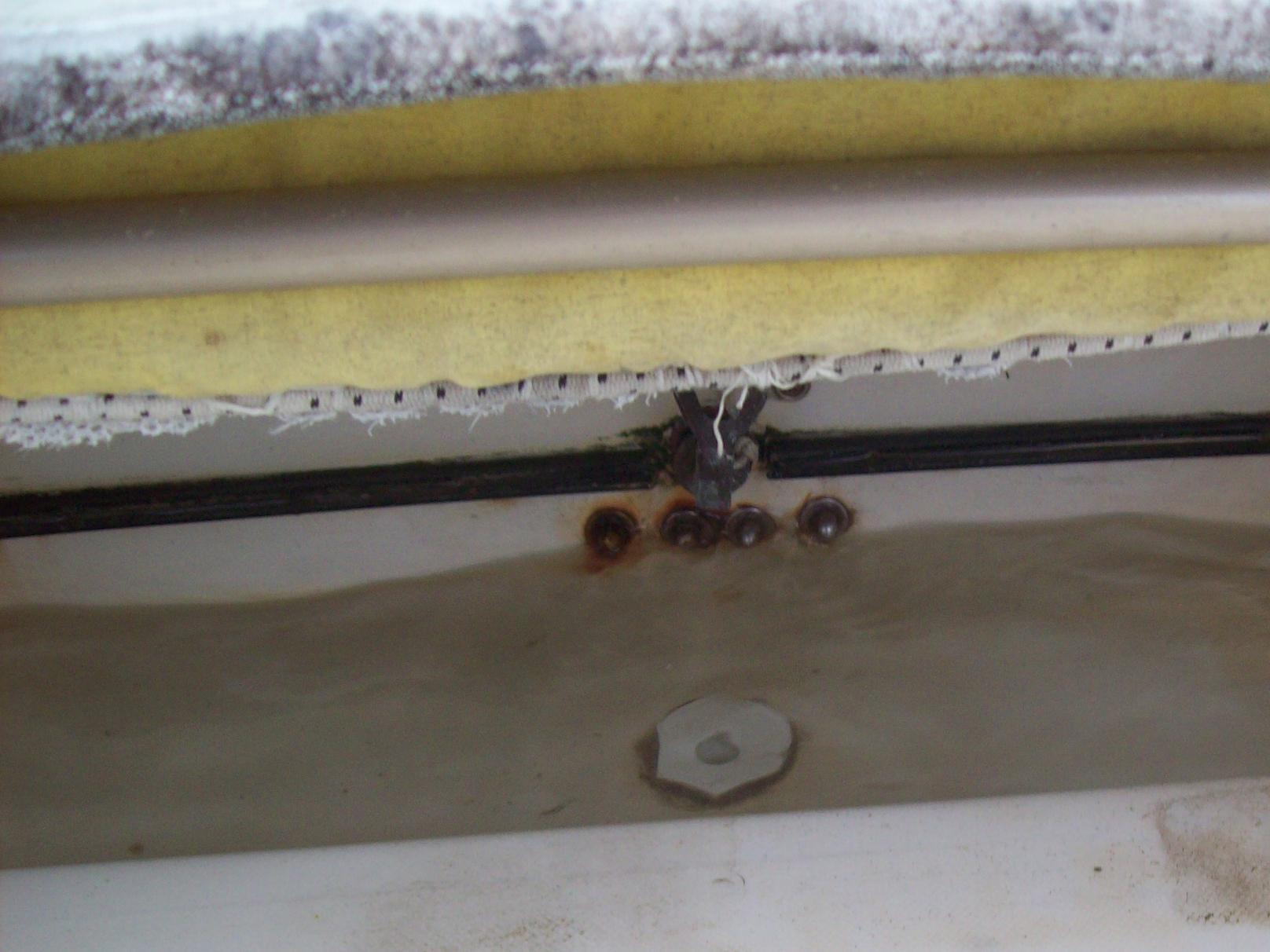

Postby SUNBIRD » Wed Jun 29, 2016 5:21 pm
Picture showing about how much water collects In cockpit with self-bailer unplugged
water in slopwell.JPG (165.5 KiB) Viewed 14614 times
I've kept my boat on a mooring for 20 years and can say without a doubt that the autobailer WILL drain the cockpit while moored. Not 100%, since the ball on mine rarely seals completely, but as long as the water inside the cockpit is higher than that outside the boat, the pressure of that inside water will force the ball down and the water will drain. The 1" drainplug above the waterline will leave a lot more water in the cockpit than the autobailer does, the level of water sloshing around in my cockpit with the bailer open is well below that 1" drain hole. I'd say I get about 1-1.5 gallons that will collect over a week's time.
I leave the plug out of the autobailer while moored during the week, then insert the plug as soon as I come aboard to go sailing. I then bail out the left over water. Before going ashore (especially if rain is predicted!) I remove the plug and any rain water drains out while at rest.
In the above picture, the black line across the well is the track that supports a floorboard that I made to cover the slopwell and allow me to strap down my 3-gallon gas tank. I have also added an after deck like on the DS I. Netting at top holds a type IV throwable cushion up under the deck for easy access if needed. As you can see, water is only up to the level of the lower gudgeon bolts.
